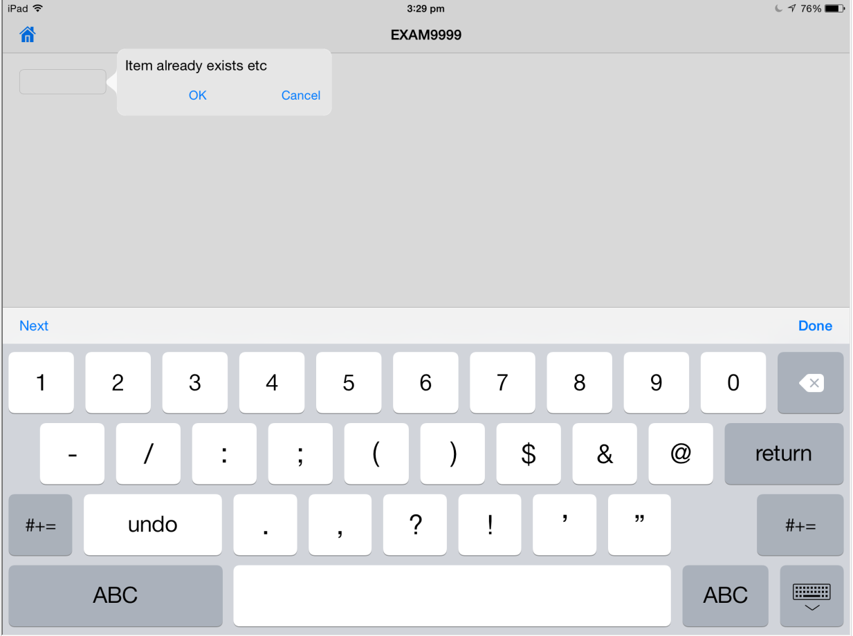

My LANSA system is out of action at the moment – but using RPG I got an example to look like this:
Is that what you have (and want) – with the focus in the input field, the keyboard visible and the pop over all displayed at the same time? If that is what you intend to do then I think you might struggle to get it to work properly – I think you normally need the user to dismiss a pop over before they can interact with the formview behind/below it. You are sort of bypassing that by putting the keyboard up with the HasFocus option and that might not reliably work.
I think that when the popover is displayed you should try not using the HasFocus(TRUE) so that the keyboard does not appear when the screen is initially displayed along with the pop over. Then the user has to use or dismiss the popover before starting to interact with the entry field. If you wanted to also disable the return key I guess you could try OnReturnKey(‘ ‘) or use the option to set the OnReturnKey property to null.
In your design is the popover meant to be fully modal – in the sense that user should use it or dismiss it before interacting with the parent formview behind/below it?
