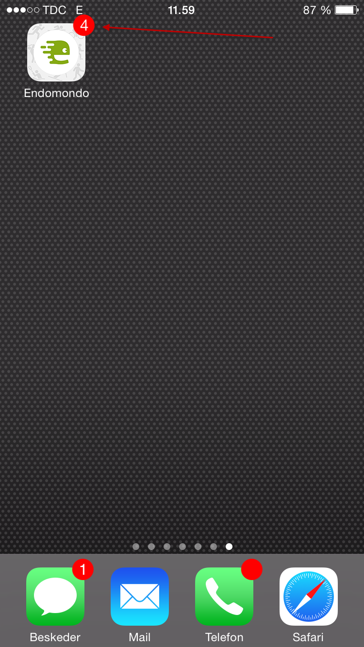

Hi.
This has pop-up once again. The customer wants to make this notification/announcement like on the image attached.
Will this come in a future version or is this not possible at all?
- announcemnt.PNG (309.84 KiB) Viewed 15974 times

Re: Notification - RDMLX
It is not possible now.
We will do for next version - but just to be clear - you would get a red circle and a variable number.
There would be no other image alteration properties.
When this feature is implemented, the way it works is that your LANSA (RDMLX) program would have to set the value of the notification count (number in red circle).
This means that you would only get the chance to change the number when the user is actively using the app - there wouldn't be a way to change the number when the app is in the background / inactive.
It is my customer which wants this function. What is it that endomondo use to get this notifikation? Is it some kind of push function?
When you say it is only when the app is activ is is possible to set this notification do you then mean that it is in the front?
Yes - that's what I mean - you could only update the red circle notification when your app is 'running'.
By 'running' I mean started and in the foreground (visible to the user).
Once it is sent to the background by the user, or the device screen is turned off, the operating system puts the App to sleep.
That seems to limit the usefulness of having the red circle notification I think - which is why I am making sure you understand this.
I know some apps can respond to 'alerts' even when they appear to be asleep - but you cannot do that at the moment in LongRange.
