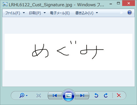

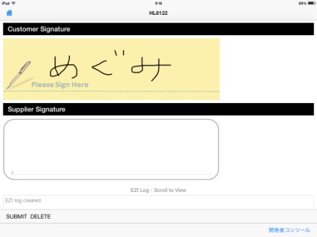

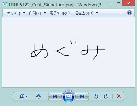

screen shots are attached:
I think the background of signature is transparent in signature.png.
I would like to save the sign like signature2.png.
- image.jpg (29.09 KiB) Viewed 5591 times
- signature.png (20.34 KiB) Viewed 5591 times
- signature2.png (24.94 KiB) Viewed 5591 times

The EZI code handling the signature request is LRNG_PROJ/QRPGLESRC member EZISRVSIGN.
It sets the property Annotation.MergewithImage to False so that only the signature is saved, not the background image.
There is currently no EZI option to change this.
You could change your own custom version of EZISERVICE - or we can do it for you and give you an updated LRNG_PROJ library.

Alternatively - after doing the EZI_SetupSignature call to EZI in your RPG program you could do a LRNG_SetProperty to override Annotation.MergewithImage property to true.
- Posts: 268
Re: [RPG]background when saving annotation
Thank you, Mark.
Do you mean in your reply "background " is PleaseSignHere.png?
I would like to save only signature without merging it with PleaseSignHere.png, but with white background.
(Still I would like to show that signature wit PleaseSignHere.png background on screen,though)
Is it possible somehow?
- Posts: 346
Try this .........
Copy to make new file <axesroot>\LongRange\resource\WhitePleaseSignHere.png (or some other name).
Use PAINT to change WhitePleaseSignHere.png to have a white background. Save the updated image.
Very important - > Use WRKLNK to check that WhitePleaseSignHere.png has *R (and only *R) authority for user *PUBLIC.
If the authority is wrong it can be very confusing because the new image will not be served by aXes.
Change EZI set up call to specify WhitePleaseSignHere.png as the background image to be used.
That should show the white background behind the signature but not save it as part of the signature.
