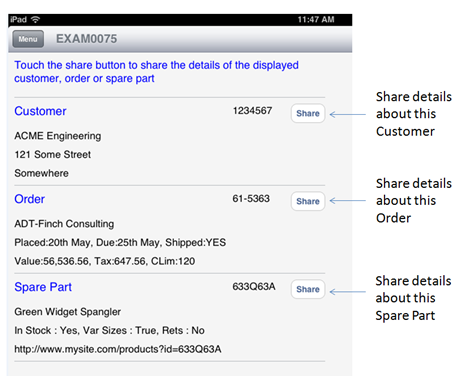

This example demonstrates a generic way to enable information ‘sharing’ by e-mail or message/SMS.
Imagine an in-field staff member using your iPhone or iPad App wants to:
• ‘Share’ the details of an overdue Order with your billing department by e-mail
• ‘Share’ the details of a customer with another sales rep by message/SMS
• ‘Share’ the details of a spare part enquiry with a potential customer by message/SMS
Following is a screen that mocks up all 3 of those situations - see the attached MS-Word document for more screen shots and the example RPG code ................
