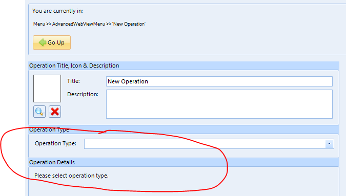

You will encounter this issue if you have an operation in your schema with unspecified operation type (see screenshot below).
A quick circumvention would be to remove the offending operation with no type specified.
