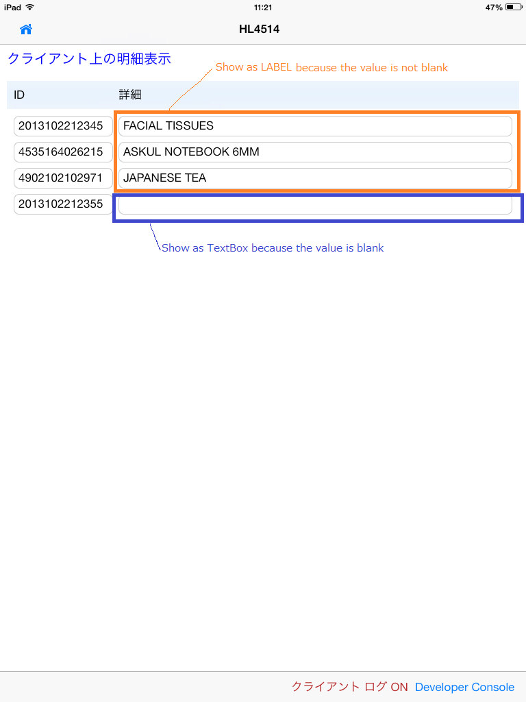

Is it possible to switch the type of column in a table on offline form?
e.g.
On row 1-3 Column 2......Data exist so it is shown as Label component
On row 4 Column 2......Data doesn't exist so it is shown as Textbox component
I tried some way but am not able to find a good way.
I'd appreciate your kind advice.
Paul

Changing the type of elements in a bound table on an Offline/Local form is very difficult to achieve at the moment. It would involve setting up the whole table manually in ECL script.
A better alternative for an Offline/Local form would be to set the column in question to a textbox from the start and use the Editable and Appearance properties to disable input and make it appear as a label. These properties would then be set as desired to change the appearance and enable input in a ECL script triggered by an event of some kind.

I tell them to use Editable True/False instead of switching between label and textbox.
