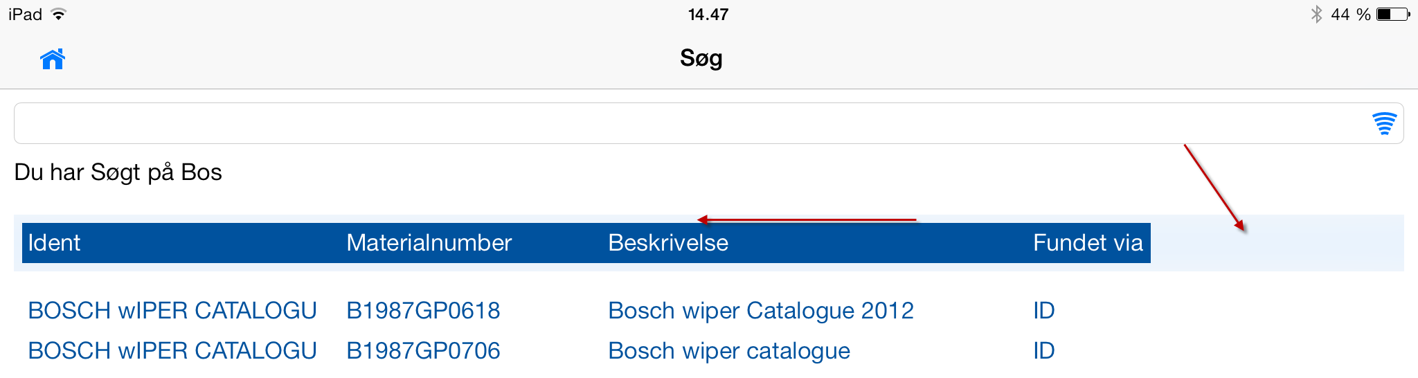

is it possible to make the color to fill out the entire header area? see the attached image
Æcom_owner.Set_Table Name(Results) Layout_Cols(1) Onrowclick(RESULTSELECTED) Border_Thickness(0) Border_Cornerradius(0) Border_Color(Black) Layout_Row(4) Layout_Col(1) Layout_Width(fill)
ÆCOM_OWNER.Set_Table Name(Results) Col_N(1) Col_Name(COL1) Col_Type('Label')
ÆCOM_OWNER.Set_Label Name('Results.Col%1.HEADER') Text('Ident') Color(white) Backcolor('#00529E')
ÆCOM_OWNER.Set_Table Name(Results) Col_N(2) Col_Name(COL2) Col_Type('Label')
ÆCOM_OWNER.Set_Label Name('Results.Col%2.HEADER') Text('Materialnumber') Color(white) Backcolor('#00529E')
ÆCOM_OWNER.Set_Table Name(Results) Col_N(3) Col_Name(COL3) Col_Type('Label')
ÆCOM_OWNER.Set_Label Name('Results.Col%3.HEADER') Text('Beskrivelse') Color(white) Backcolor('#00529E')
ÆCOM_OWNER.Set_Table Name(Results) Col_N(4) Col_Name(COL4) Col_Type('Label')
ÆCOM_OWNER.Set_Label Name('Results.Col%4.HEADER') Text('Fundet via') Color(white) Backcolor('#00529E')

The table column layout in your post does not set a value for the column width property. The default value for the column width property is 'fit'.
If you set the column width property for your last column to 'fill', my testing shows that the background color will fill out to the end of the table.
Example;
#COM_OWNER.Set_Table Name(Results) Col_N(4) Col_Name(COL4) Col_Type('Label') Col_Width(fill)
