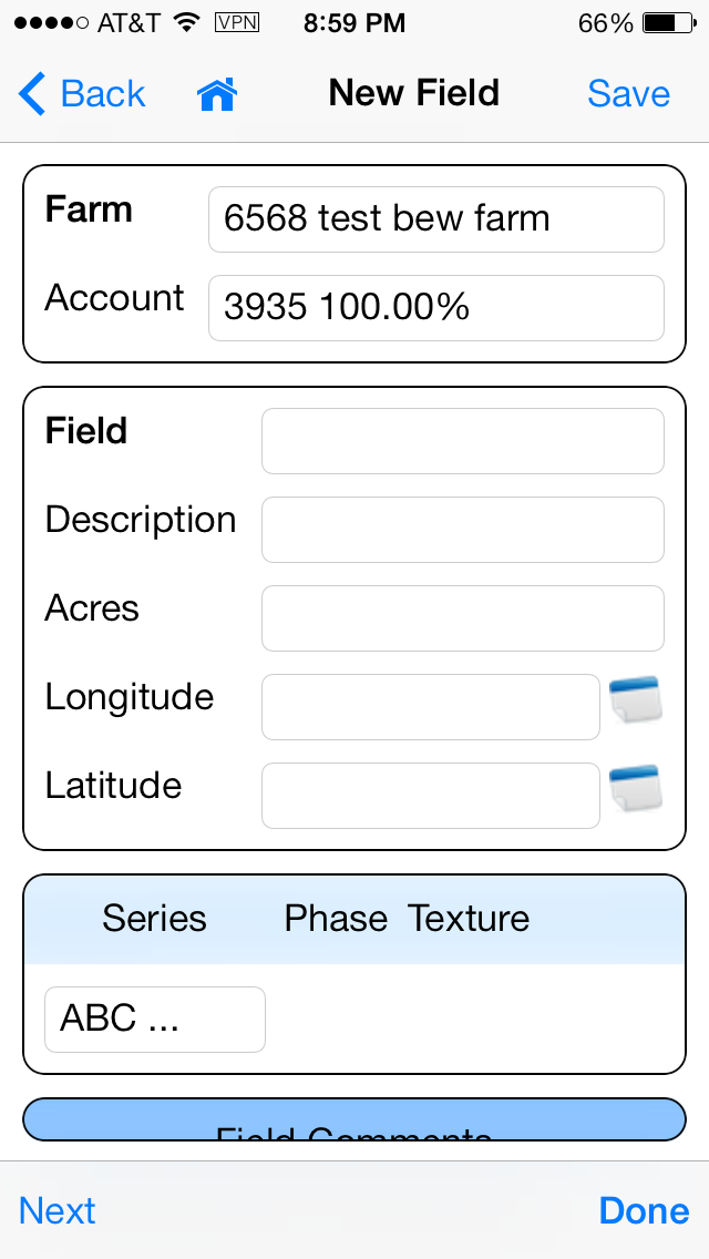

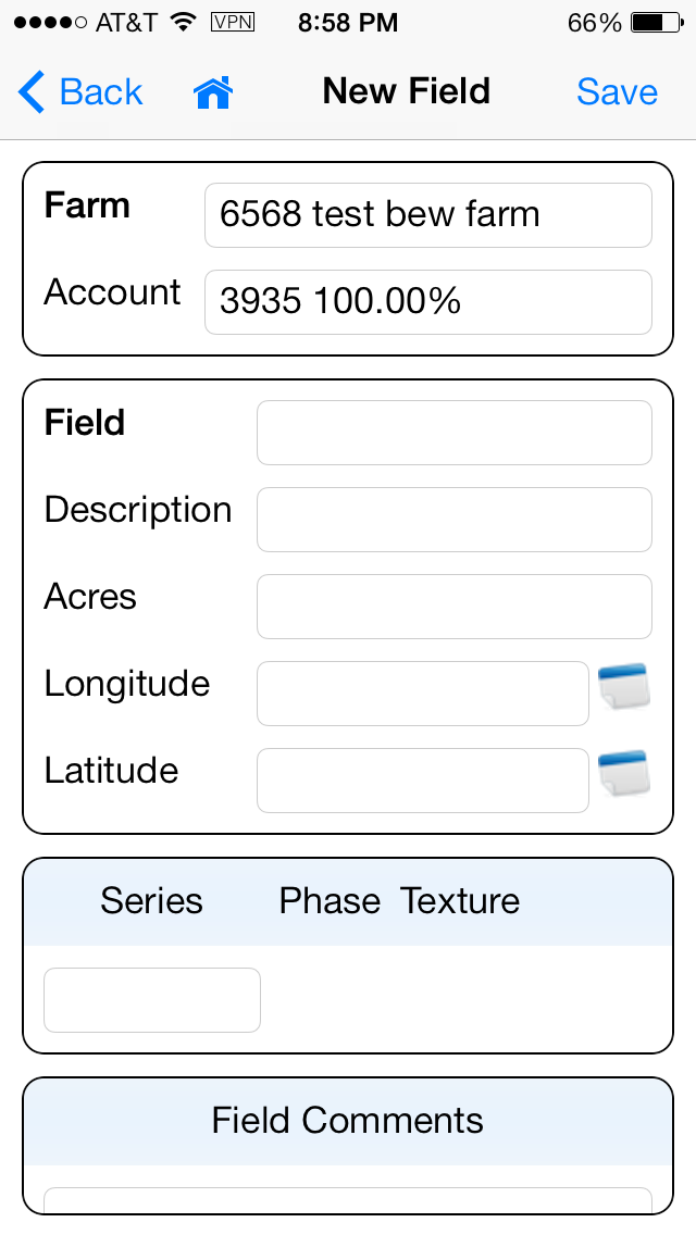

The Seires is the field I am referring to. Here it is before touched
DD before focus.PNG (74.04 KiB) Viewed 7697 times

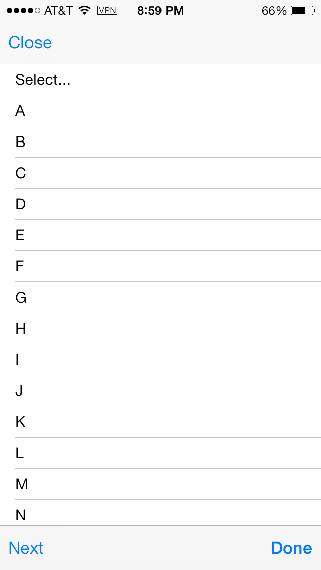

After manual touch it expands to letters dynamically determined from DB file
DD on touch letters.PNG (32.58 KiB) Viewed 7697 times

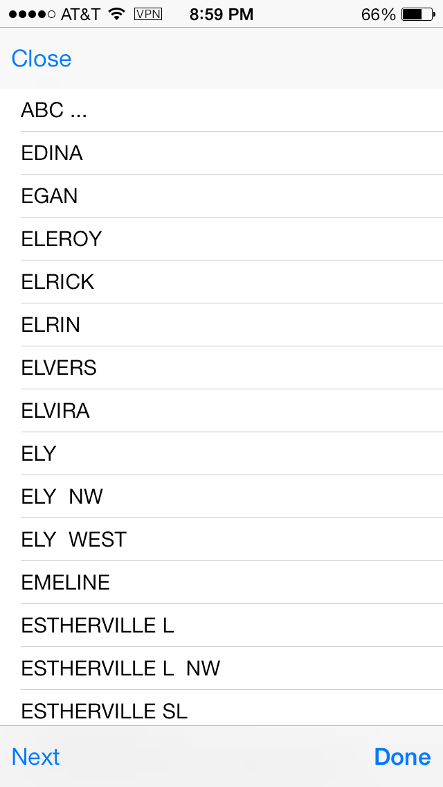

Here is problem after letter selected the drop down colapses
dd after selected (problem).PNG (80.24 KiB) Viewed 7697 times

So user has to manually retouch same field to expand. This is what I want it to do but since the field is already in focus it will not expand. telling setting entire form to null and refocusing does not work either.
dd manually expanded by touch.PNG (51.7 KiB) Viewed 7694 times
