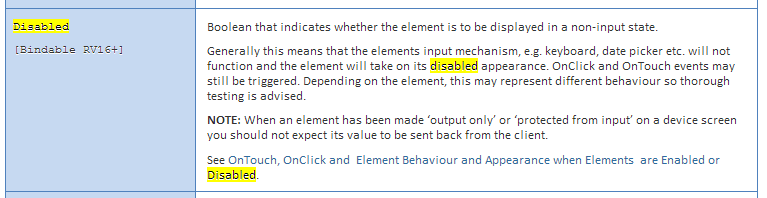

Re: Change DD to label bug?
The documentation describes the situation I think:
A user cannot change the content of a disabled element - but how it is displayed and whether they can click or touch it still is a different matter.
There is a quite new section in the documentation about those topics - http://www.longrangemobile.com/docs/LRP ... areena.htm
That indicates the disabled appearance of a dropdown is the same as a label - which is what you are looking for?

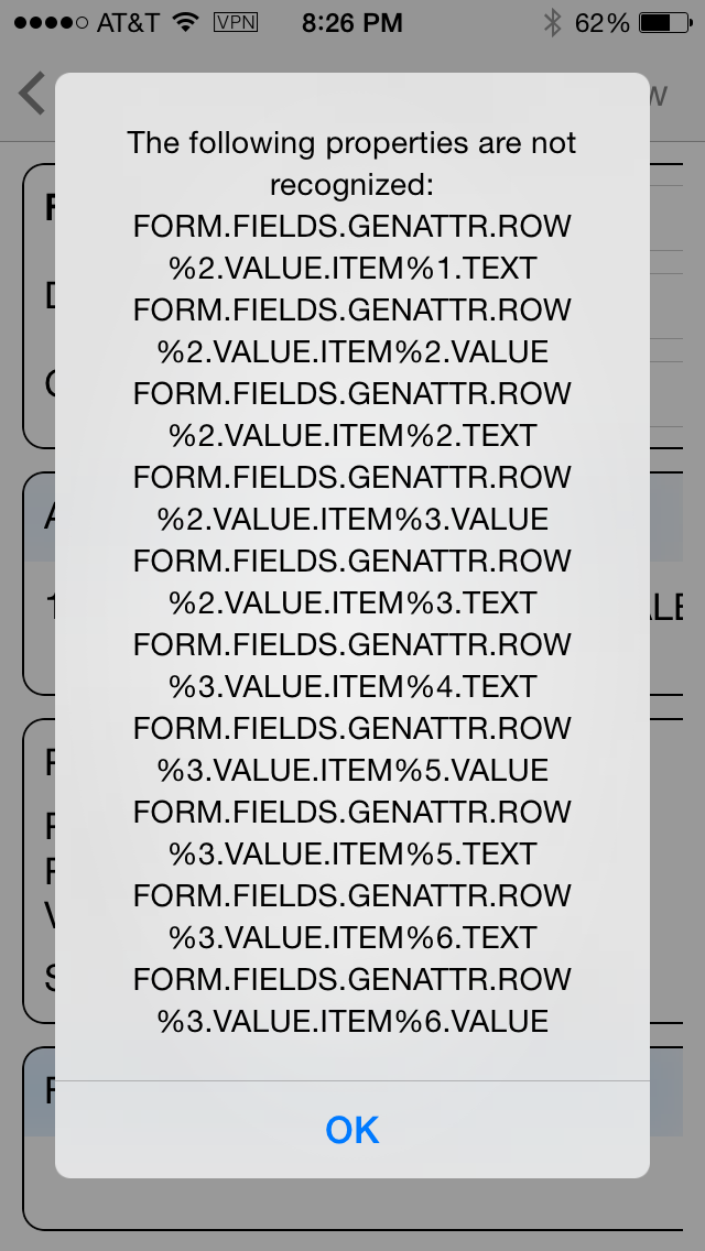

Post by stevec »
Here are errors
I tried setting up simple example and of course it worked. So I took it to 3 levels (program a calls program b, c passing in com_owner ref --- origram B is issue and calls program d for dropdown) deep like the actual but still worked.
