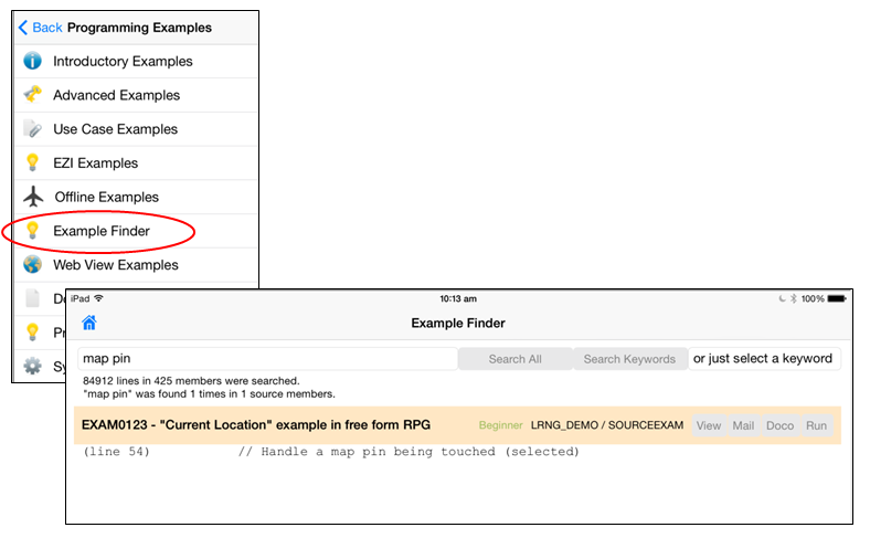

Re: (RPG) MAP and Multi-Pin
Can I plug the RPG Example Finder in the shipped LongRangeDemo.lxp schema here?
It may help find what you want more quickly than scanning menu items.
