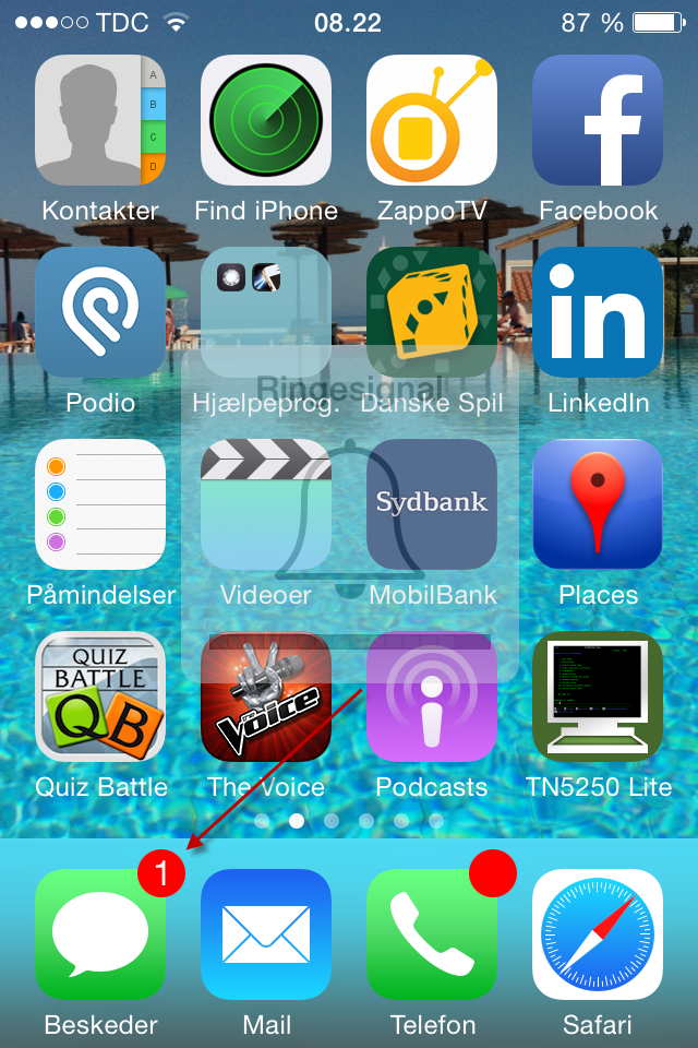

I want to make news section in an app for one of my customers. I want to make the notification like when you get an sms (see attached image). I would like to set some timer i the app so it make a request to the server and then check if the device have seen the news or not. If the device have not seen the news it maks a notifikation.
Is it possible to make this notification?
is it possible to a unique id for the device?
- IMG_0542.PNG (640.84 KiB) Viewed 15626 times

If you only want the overlaying red number (but no associated notification message) then this may be possible in a future release.
Re: Notification - RDMLX
it is only the overlaying red number I want. If the user see the red number then they open the app and choose the news menu item .

in the incident list (demo) you show a icon with at number beside. is it possible to change the icon in the menu the same way? I would like to make a news menu item where I show how many unread news the user have.

Generally this is done by putting 3 things into the same form view grid cell. The main image, a small red circle image and then a label containing the variable “n” number to be displayed. These all overlay one another using the zIndex to control what goes on top of what (http://www.longrangemobile.com/docs/LRP ... erties.htm).
This might be set up in a VL reusable part or as an RPG procedures so that it can be reused in many different form views. Once you can this you call it asking it to ‘insert’ image X, with overlaid number N into a form grid cell row and column number. This can be fiddly to get set up initially as you need to use padding properties to force the “n” label to appear on top of the red circle, etc, etc.
It may also be worth making your entire VL reusable part (or RPG sub procedure) create a sub-form that contains the overlaid images and label. This makes it fairly easy to inject your reusable part in to table rows – where a table column is made up of sub-forms.
I would like to controle the icon in the main menu. You have this command: COM_OWNER.Set_SystemMenu Name() Hidden() but you can not control which icon you want to have in the menu. If we could control the icon like you (Mark) described in your last post we could make some "sort" of notification for the user.
