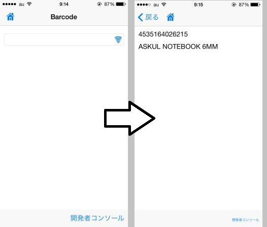

I would like to create a program which scan a barcode,look up the local database and show the details (from the local database) on the next formview in presentmode:stack.This should work in offline.
However, I will get an error when I execute it in airplane mode(i.e. in offline).
Is it possible to show a formview in presentmode:stack in offline environment?
I appreciate any advice.
