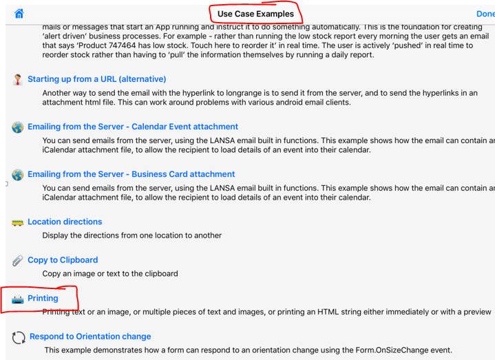

LongRange has the ability to send HTML output to printer directly.
On iOS, the printer must be Air-Print capable.
Have a look at the printing example in the lansademo schema, under Programming Examples >> Use Case Examples >> Printing (source code LREX0112)
If you can't find this example, most likely you have an older version of the demo material, let us know and we'll send you the updated material.
Give this a go and let us know if this would satisfy your printing requirements, any suggestions are welcome.

I do have that use case example.
