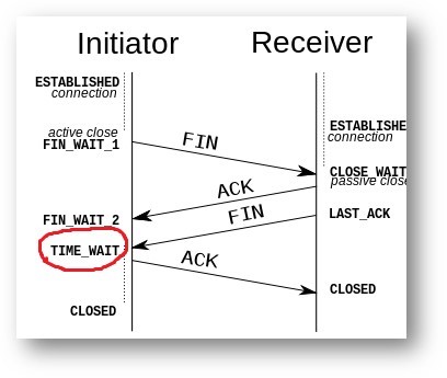

After each request, the state will immediately become to Time-wait. (see Picture 1)

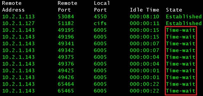

In TCP standard, Time-wait means that the connection is terminated, but before changes state to Closed, host needs to wait a short time to be sure the client received ACK flag. (see Picture 2)
This is what I read from https://en.wikipedia.org/wiki/Transmiss ... l_Protocol:
TIME-WAIT
(either server or client) represents waiting for enough time to pass to be sure the remote TCP received the acknowledgment of its connection termination request. [According to RFC 793 a connection can stay in TIME-WAIT for a maximum of four minutes known as two MSL (maximum segment lifetime).]

I think the behavior is correct.
TIME-WAIT

- [Picture 1] the TCP state is Time-wait after each request

- [Picture 2] Time-wait will change to Closed after waiting a short time
