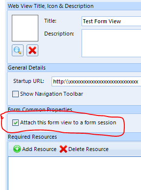

When using aXes-Mobile (aXes 5250 sessions) in LongRange web views the session will end when the user navigates to another formview or webview.
There is an option in LongRange Studio to keep the webview session alive:
You also need to account for the resources required to keep web view sessions open (especially more than one) on mobile devices.
