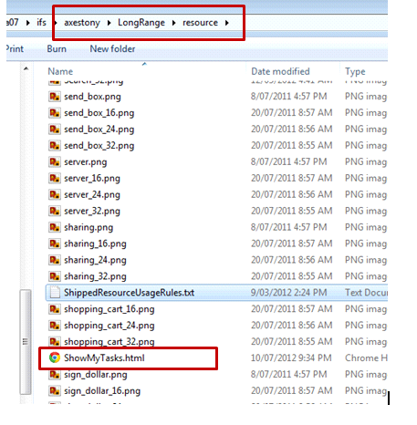

1) Where do I put my HTML files (also images & JS files).
You need to put that in the /LongRange/resource folder, together with other static resource files.

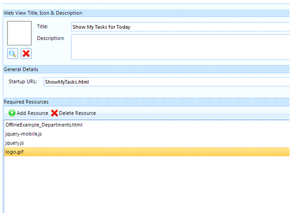

2) If my HTML page is using images, external CSS, or scripts, how do I tell LongRange to download all the required files as a unit as they would be available offline?
You do that from the Web View editor in LongRange Studio.
There is a section called "Required Resources" in the Web View editor - that is where we put the list of files that are used by our offline HTML page.
For example, that's where we should put our jquery.js and .css files if we are using jquery.
Images used by the HTML page should also go there.
