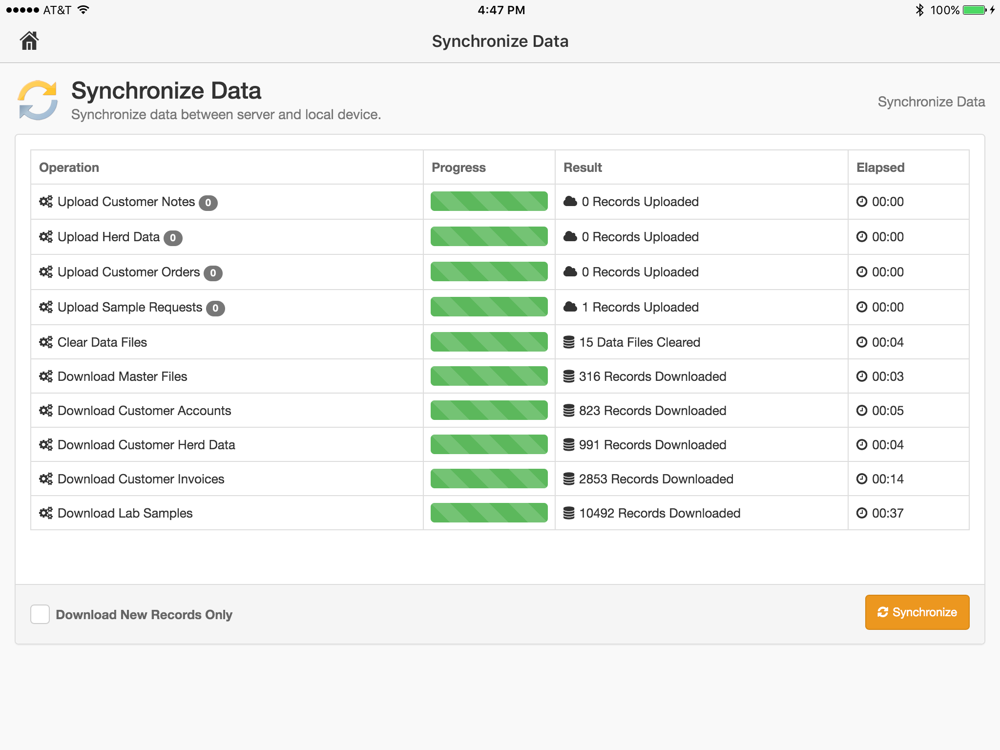

The LANSA webroutine outputs the JSON in a format where the list header (with column descriptions) are in a separate object (lists.list.header) than the list entries (lists.list.entries)...
I process the data in this way, getting 50 entries at a time (which gives very good performance):
1. Create beginning of insert - (INSERT INTO TABLE(Column1, Column2...) Values(
2. Iterate through the entries using jQuery each(), building value string - (Entry1Value1, Entry1Value2), (Entry2Value1, Entry2Value2)
3. Finish insert once 50 entries or entries.length is reached
I am creating the beginning of the insert (TABLE(Column1, Column2...)) dynamically using sql: "select sql from sqlite_master where type = 'table' and tbl_name = '" + tableName + "'" and parsing the column names with regex: var columnNames = stringValue.replace(/^[^\(]+\(([^\)]+)\)/g, '$1').replace(/ [^,]+/g, '').split(',');
Again, this works great and is reusable, I just must ensure that the list entries in my Lansa webroutine exactly match my table columns...and I could change either....but often I choose to change the table because the app is in early development and because I sometimes choose to just have the columns in a more logical sequence.
I attached a screenshot...this method performs very well for downloading and inserting a good deal of records.
