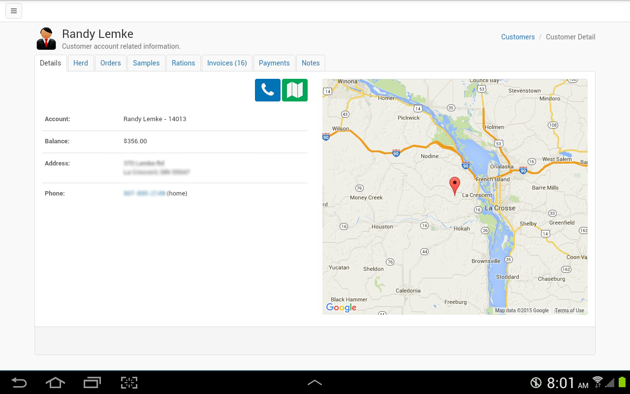

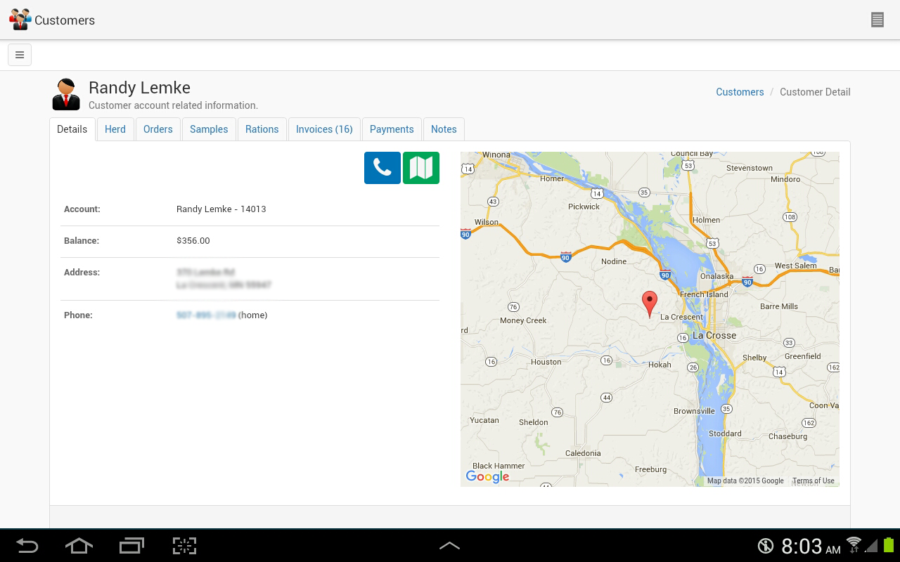

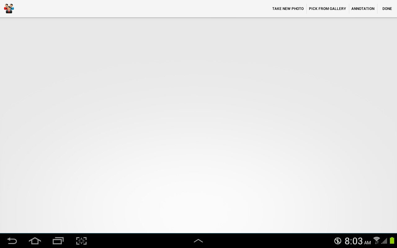

Also, I want to mention another issue I discovered with the HideTitleBar property. In Android, the title bar is hidden initially but is restored when using the LONGRANGE.Camera API. I will attach some screenshots to illustrate what happens.

Thanks Edward, it's really great to hear that you have found LongRange useful in your project.
RE the title bar in Android re-appearing, I will get that fixed.
Before I submitted the RV18 update to the App Store (in about 2 weeks time), I will provide you with a test build, so you can verify that all your code works as expected in this version.
