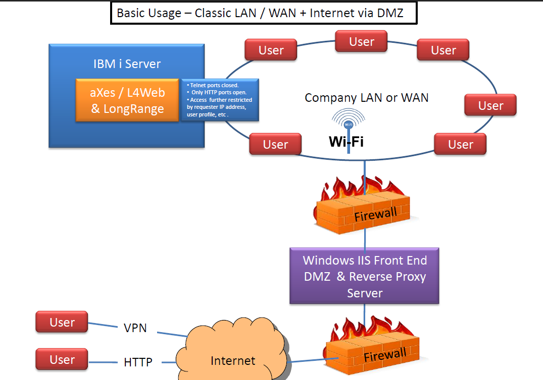

• If it is restricted on IBM i, I don’t understand what was said in Tips, Techniques and Examples | Some basic security configuration combinations by MarkDuignan » Wed Aug 22,012
Basic Usage - Classic LAN/WAN  + Internet via DMZ

The wording in the Getting Started guide is possibly heavy handed. What it is trying to express is that the client is not a web browser – just as a client for web services (say) may not be web browser. Therefore your L4Web server instance cannot respond the client as if it was a web browser. This means browser based authentification techniques, redirections and proxy server ‘tricks’ are all likely to cause issues with the client.
The diagrams use reverse proxy servers – which is a recommended and supported technique for use with aXes-LongRange. Personally I have never seen this type of configuration used with a L4Web instance - people tend to use the ‘model B’ configurations instead – but I can see no particular reason why you could not get it to work.
