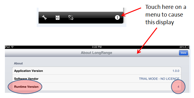

On a menu on your client touch the “i” information icon.
The resulting display should show a Runtime Version number (eg: 4).
When you see ‘requires RVn+’ in documentation it means that you need to be using a client with runtime version ‘n’ (or later) to use the feature.
