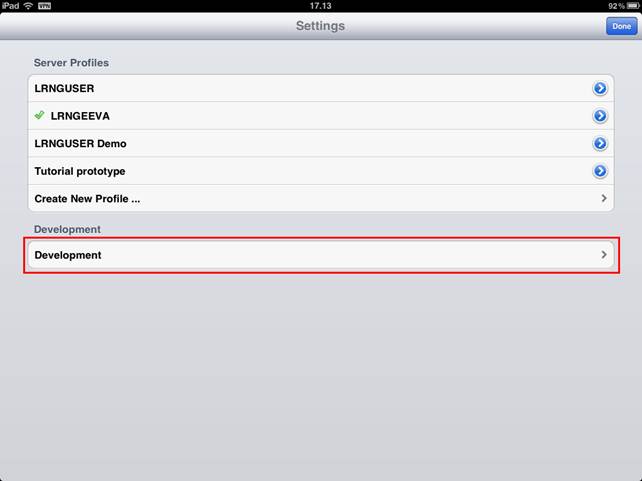

    • In Settings select Development:

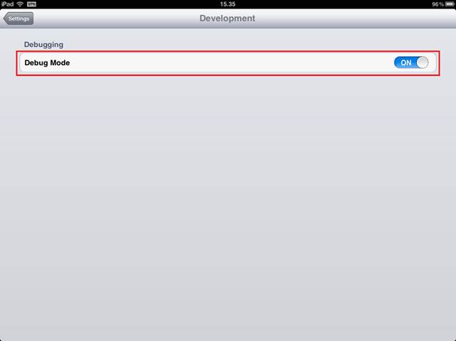

    • In Development set Debug Mode on:
      This will allow the app to wait longer for the response.
