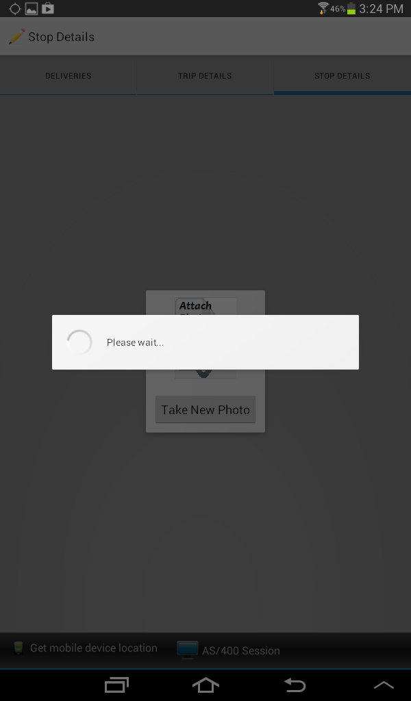

When I touch the 'Image' element on Android, the form shown in the attached is displayed, but once the "Please wait..." message disappears, the form with the "Take New Photo" disappears, so that I am never able to take a picture.
JJ
JJ
- Android Image.png (37.02 KiB) Viewed 4596 times

Do you by any chance have the "OnClick" event handler set on your image?

Yep, and that was the problem.
I'd never tested this Android, and it's always worked as expected with iOS, even with the 'onClick' event set.
Apparently there is some difference between how Android and iOS interpret this?
Anyway, it works now on both platforms, so thanks!
