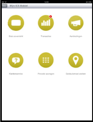

The concept of a ‘home page’ or ‘main menu’ is common in mobile applications. Typically these look like miniature desktop with large easy to select icons – sometimes overlaid with some sort of short summary (eg: messages waiting count) or something to attract a user’s attention to something they need to look at.
Here is an example of a Dutch demonstration ‘home page’ done using LongRange (it was set up to mimic the home page of real application as part of a proof of concept exercise) …
