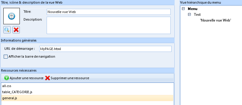

Put you JS, CSS and HTML files into your <root>/LongRange/Resources folder.
In LR Studio define a webview in your schema that will load up your start up HTML page (eg: like the web view named EXAM0026 in the shipped LongRangeDemo).
In that webview definition add the other JS, CSS and HTML files to the ‘Required Resources’ list.

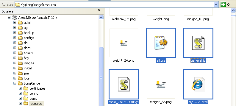

see in attachment my schema and the <root>/LongRange/Resources folder.
But when i refresh my schema on the iPad, this does not work.
What i have miss ?

Using a user profile with appropriate authority execute this command:
CHGAUT OBJ('/<AXES-FOLDER>/LongRange/Resource/*.*') USER(*PUBLIC) DTAAUT(*R) OBJAUT(*NONE)
Now check that a test file has user *PUBLIC having *R (and only *R) rights to the file:
WRKLNK OBJ('/<AXES-FOLDER>/LongRange/Resource/gerneral.js')
Then use 9=Work with authority and check *PUBLIC has *R (and only *R) rights.
