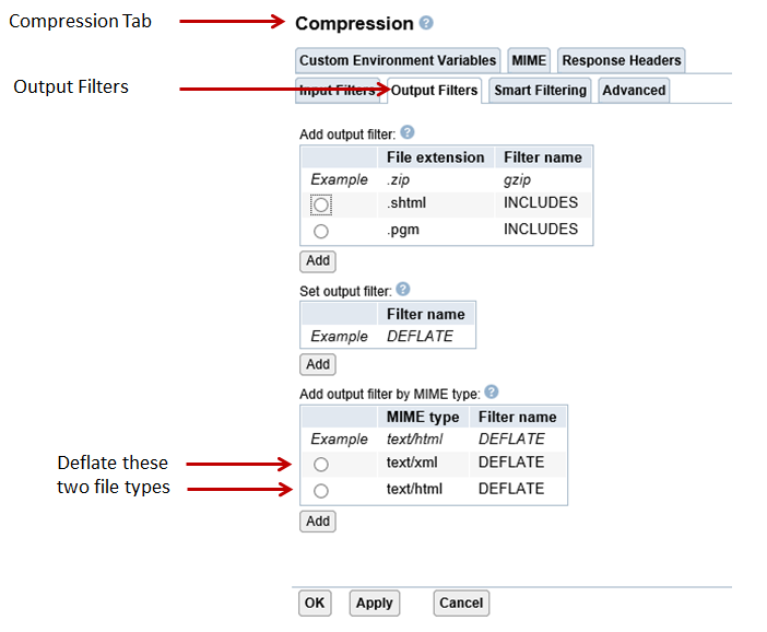

A basic way to improve the performance of HTTP applications is to make sure you have HTTP output compression turned on.
For RPG LongRange users this would normally be turned on by default.
For LANSA LongRange users it depends on how you have configured your IIS (Windows) or Apache (IBM i) HTTP web server.
This article discusses how to do this for V5R3 on an IBM i server (the approach would be very similar for all IBM i versions of Apache):
http://publib.boulder.ibm.com/infocente ... cmprsn.htm
This boils down to configuring your Apache web server instance to compress certain types of files before sending them to the client:
