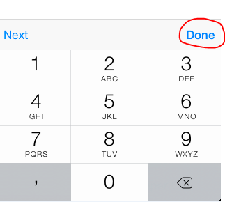

There is indeed a way to change the input type to number, without changing the keyboard to numberpad.
But before we go there, I'm wondering about what you said: "I also tried OnValueChange but this still needs the user to do something to trigger it".
If you set the OnValueChange handler, the form should get submitted when the user types in a document number and touches the "Done" button above the keyboard:

DavidS
Posts: 15
Joined: Wed Jan 22, 2014 7:41 pm
Re: (RPG) OnReturnKey in iphone
Post by DavidS »
Thanks for the reply, lesson of the day "get multiple users to test something before deciding it doesn't work" not owning any apple device myself I'm working on feedback alone and having asked more users the OnValueChange tag does seem to do what we're after in the program.
