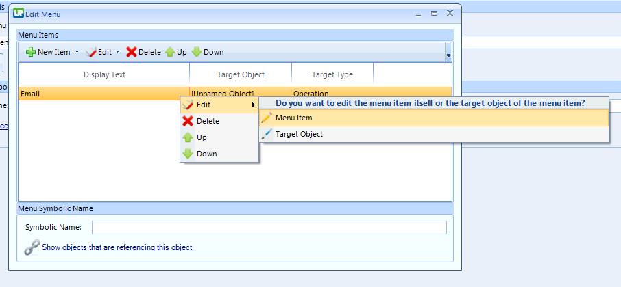

Notice the Email command, defined as a menu item, has the simbolic name cmdEmail. This is required so that the command can be referenced programatically (by LREX0314 in this case). Ensure your form command has a symbolic name defined in your schema. The symbolic name is added by editing the form command menu item.
