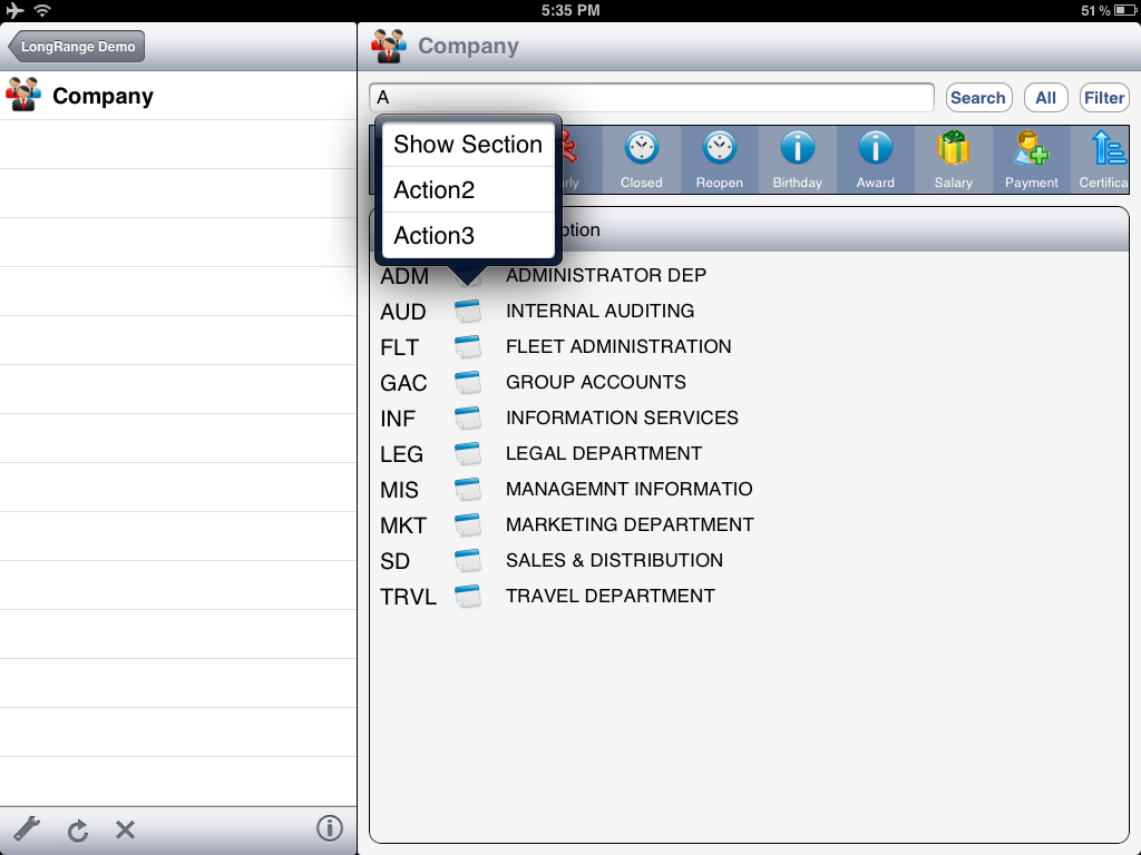

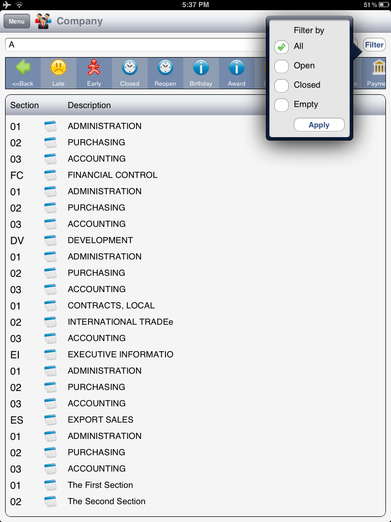

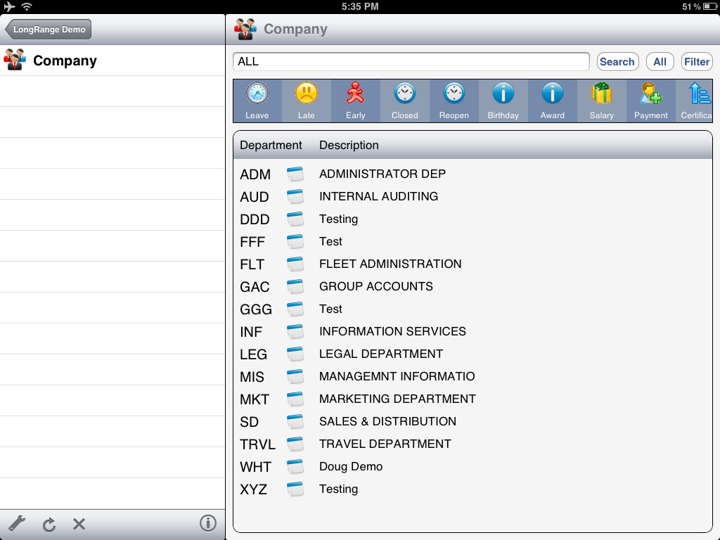

I have been wrestling with this topic as I am working on a complex situation that has lots of information (ie a very wide list but best viewed as multiple tabs) with each entry having perhaps 20+ options that could be applied to it and the resulting screen(s) could be the same complex style or a simple flat panel.
To this end I have used the horizontal scroller approach and these screens are working prototypes (but not every option or feature has been completed and nor have the correct icons been used).
You should get the idea though.
Has Scrollable List of "tabs" Search
Has optional filters (over to the right hand side provided using a Pop Over)
Has Drilldown (and/or touch for default action)
Has navigation Back via the Scrollable "tabs" as well as degrading nicely on mobile as well as orientation change.
All together a great product.
