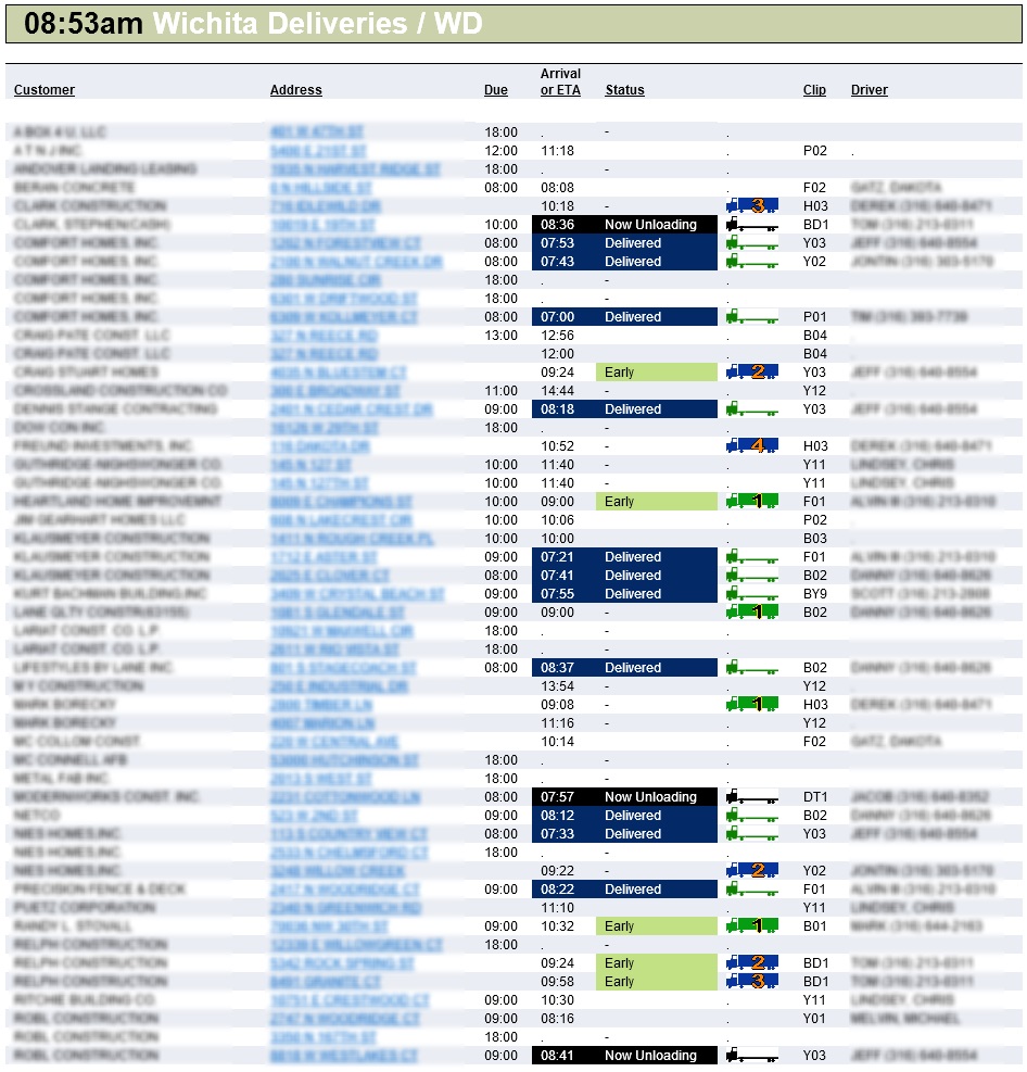

The type of stuff on the site is typically dashboard-type reports generated by the WebFocus tool: specifically we want to expose the 'Deliveries' report (attached).
Thanks.

- Web Deliveries.jpg (257.48 KiB) Viewed 7617 times
