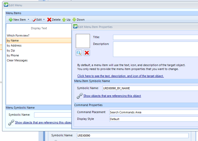

Is it now possible to clear the Search area (see below)
Re: LANSA V11 Search Area
I think it is possible, provided you assign a symbolic name to the menu item associated with each type of search.
In the LANSADemo schema, program examples, use case, searching,
edit the menu items
edit the Search By Name Menu Item and give it the symbolic name LREX0090_BY_NAME.
Now, in the LREX0090 lansa component, modify the clear messages button action as follows:
When (= CLEAR)
* Clear Messages
#COM_OWNER.IsNewForm := True
#uInRow := 0
#Com_Owner.uLog Text('Log messages cleared')
#Com_Owner.Set_Null Property('/Form.Menus.LREX0090_BY_NAME.Search.Value')
That should now reset the search value to null when you press clear messages.
edit the menu items
When (= CLEAR)
* Clear Messages
#uInRow := 0
