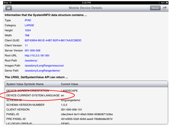

Could you run the shipped RPG demo?
Programming Examples -> Use Case Examples -> Mobile Device Details.
Then take a screen shot and post it to the forum?
Eg: I see this. The language code shows an “en” …..
This is shipped RPG example program LRNG_DEMO/SOURCEEXAM/EXAM0011.

if I understand correctly, the variable ClientLanguage found in the SystemInfo can not be read directly to determine the language used on the iPad.
In the EXAM0011, it uses a LRNG_GetSystemValues with CURRENT-DEVICE-SYSTEM-LANGUAGE parameter.
This is what I need.
thank.
thank.

The SystemINFO documentation is incorrect.
There is no language field in the shipped data structure .........
What RPG SystemINFO.xxxxxxxx variable name did you use in your original code?
We will amend the doco.
The reason for this change (which was done at the last minute) is that in theory the language can change while an App is active (eg: Italian and French speakers sharing a warehouse device). Not sure whether you would bother to accommodate this in an application though.

D 11A What RPG SystemINFO.xxxxxxxx variable name did you use in your original code?
