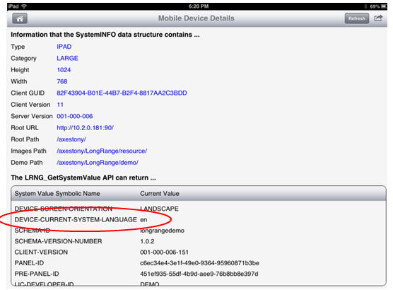

Could you run the shipped RPG demo?
Programming Examples -> Use Case Examples -> Mobile Device Details.
Then take a screen shot and post it to the forum?
Eg: I see this. The language code shows an “en” …..
This is shipped RPG example program LRNG_DEMO/SOURCEEXAM/EXAM0011.

by Fabrice Geay
Hi marck
if I understand correctly, the variable ClientLanguage found in the SystemInfo can not be read directly to determine the language used on the iPad.
In the EXAM0011, it uses a LRNG_GetSystemValues ​​with CURRENT-DEVICE-SYSTEM-LANGUAGE parameter.
This is what I need.
thank.
