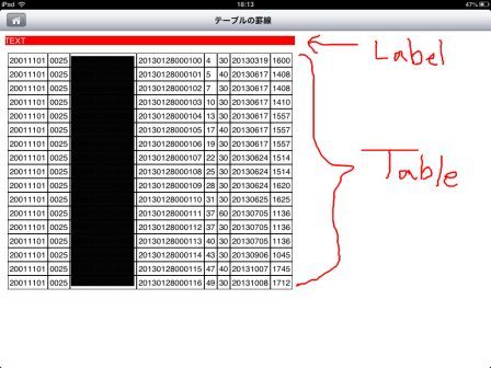

I've created a formview which has a label above a table.
However there's a gap between the label and table but I don't want to have a gap between them.
Is there anyway to delete this gap?
I've created a table without any border but I put a border around every items.
The label is defined 1 row upper than the table.
Table has no header.
I appreciate your advice...

By default all the cells on a form are spaced out.
The label is in one cell, the table in another - so try LRNG_SetNumProperty('/Form.Grid.Cellspacing' : 0 );
If you still have space you could try setting the padding on the label and table to zero.

Thank you,Mark.
It's better, but still it has a gap.
And when I re-load the formview,the gap become bigger...I don't know why.I'll find out.
If you have any other idea, could you please let me know?
Otherwise I'll tell the customer this.

Try making the table do this:
     A                                       PADDING: 0
     A                                       INNERPADDING:0
and make the program do this:
           LRNG_SetNumProperty('/Form.Padding' : 0 );

Thank you,Mark!
I was able to have an expected result with making the table with padding and innerpadding zero, and making RPG code to use LRNG_SetNumProperty('/Form.Grid.Cellspacing' : 0 );
Perfect.
