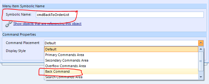

Designate a command as your "Back" button as per screenshot below.
You then need to set the operation to be performed for that command (using the System.Menus.XXXXX) where XXXXX is the symbolic name of the menu item as defined in Studio (cmdBackToOrderList in example above).
