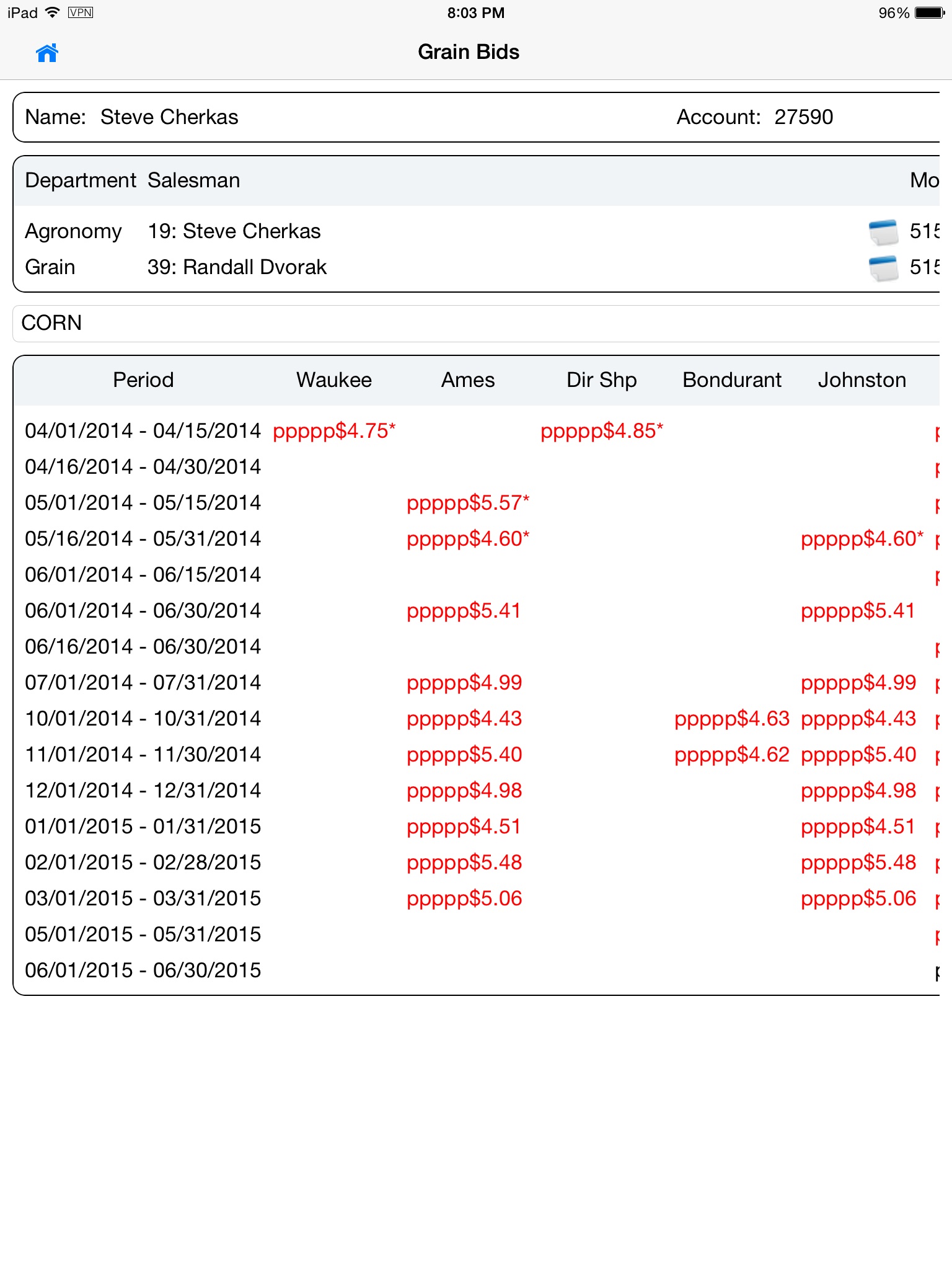

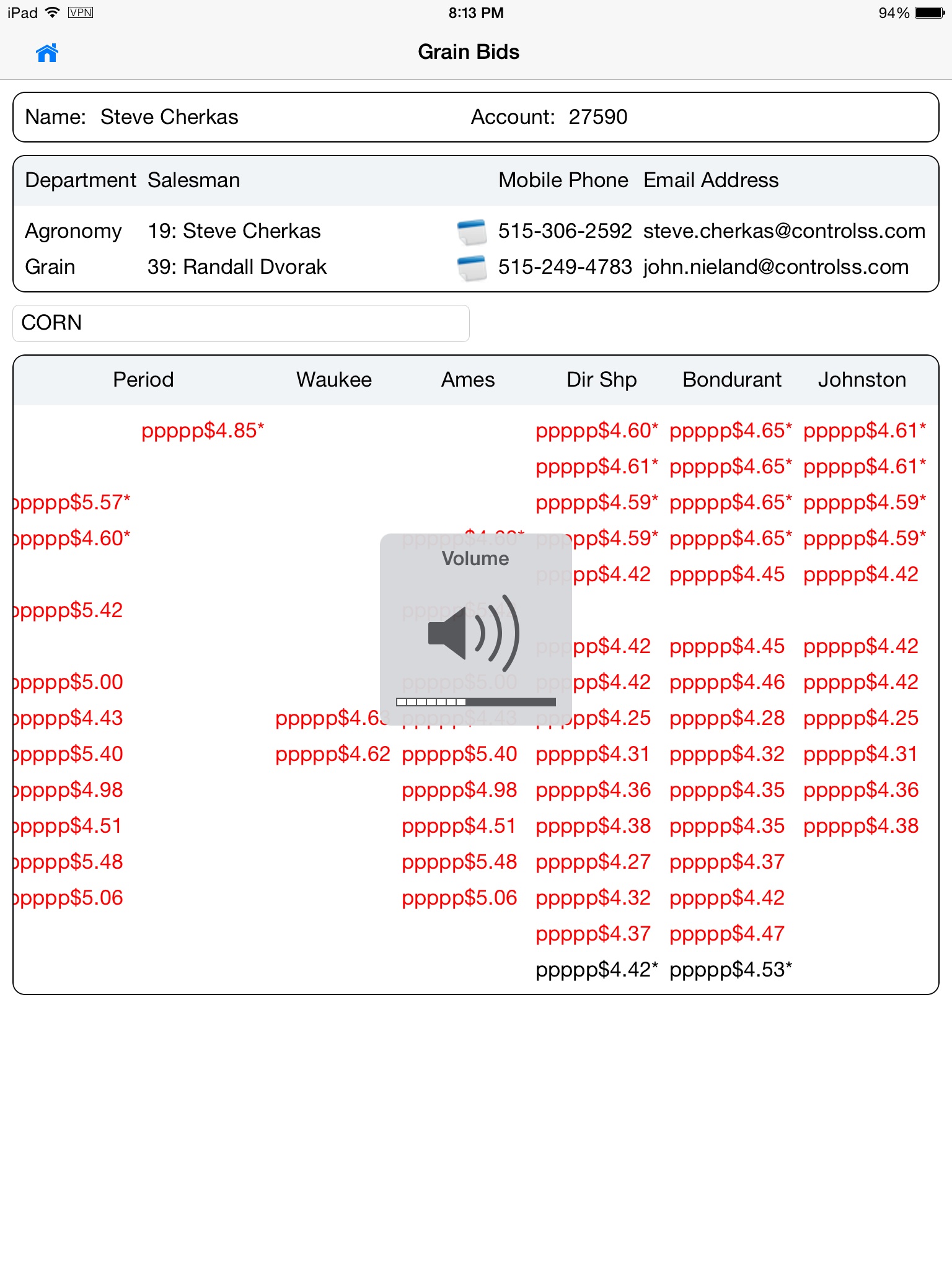

I can get it to scroll right by leaving grid column default to fit. But the upper tables that we're looking good filling out the width now extend to match the larger table. How can I keep upper tables filling width but let lower table scroll?
If I make it fill that works but lower table will not scroll column headings just the rows of data so you can't tell what the column header is.

Distributecols(Last) did not help. appears to have done nothing. tried on the set_table and also on the set_form.
My grid row 4 column 1 is the problem.
Row 1 has 2 columns
Row 2 has 1 column with table
Row 3 is 1 column drop down
row 4 has 1 column with table. When it is too big too fit is when I have the problem . If I leave it default fit and table layout_cols then width is good but horizontal scroll is rows only not column headings (if column headings too that is what I want). If no table layout cols then the top 3 go as wide as last making it look funny, but last table scrolls correct

Re: When 1 table is bigger than screen width
In the screen shot - the very first screen element 1 (Name and Account) has a border right around it.
What type of element is that ?
It looks like it is spanning two grid columns?
