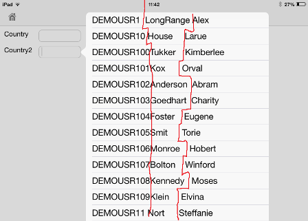

I would like to set dropdown text using 3 data fields, for example UserID + SURNAME + GIVENAME.
These data are retrieved from a file.
However, when showing dropdown items on the screen, these texts are not aligned.
It seems that data are trimmed automatically, and shown as if it is not aligned.
Do you know how to align the text as SURNAME starts from the same position and GIVENAME starts from the same position in the dropdown text?
Or is it not possible to do so?

I don’t think you can format the content of individual items in a drop down’s value list.
You could put a little ‘prompt’ image beside the field – and when the user touches it you make a popover appear.
The pop over could contain a table with 3 distinct columns in it. When the user touches a pop over table row that value is updated back into the entry field on the screen.
Maybe the pop over could also appear just by touching the field - no image required?
You could make this a generic solution so that it can be reused on many different forms and with different data content.
