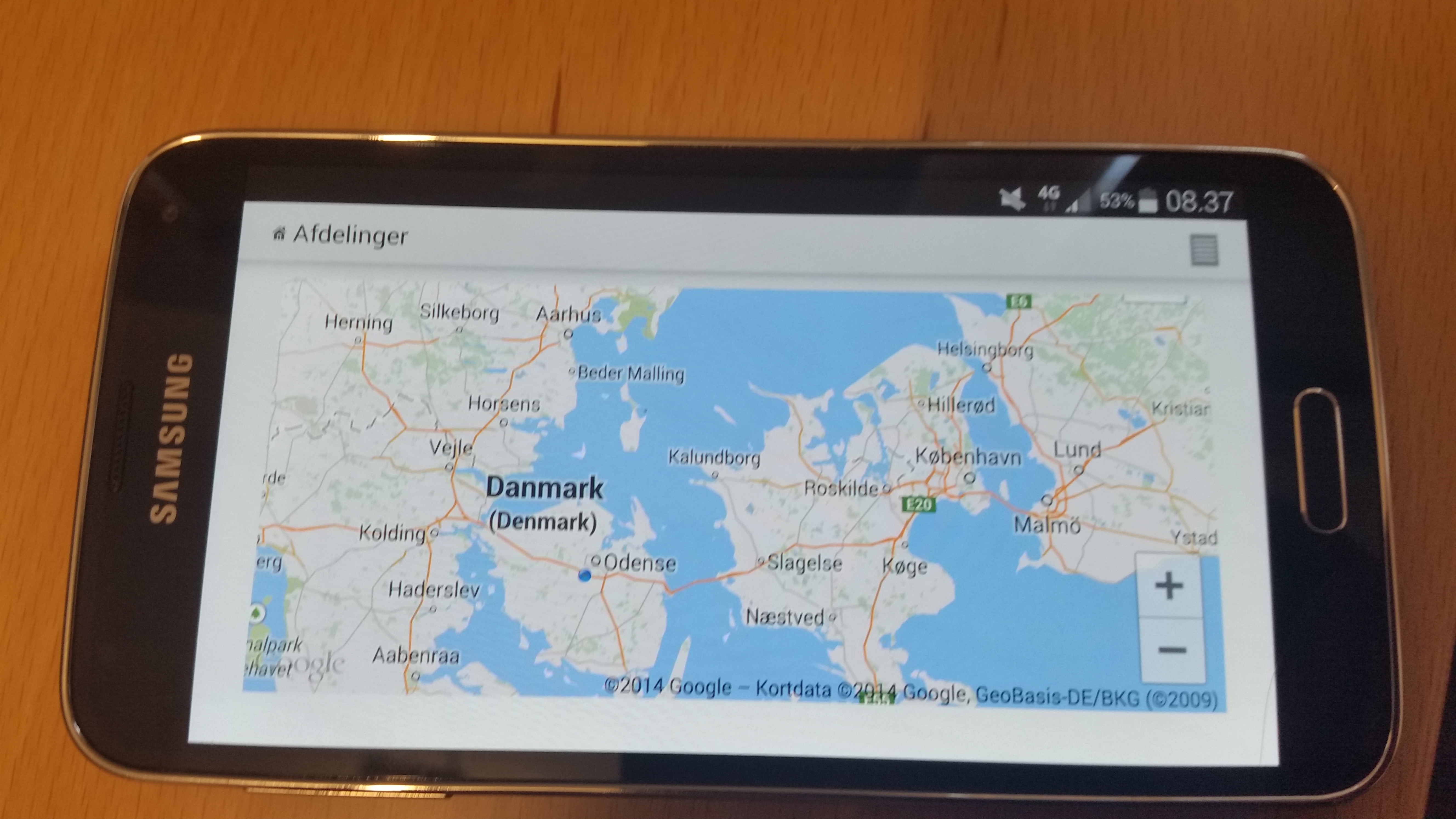

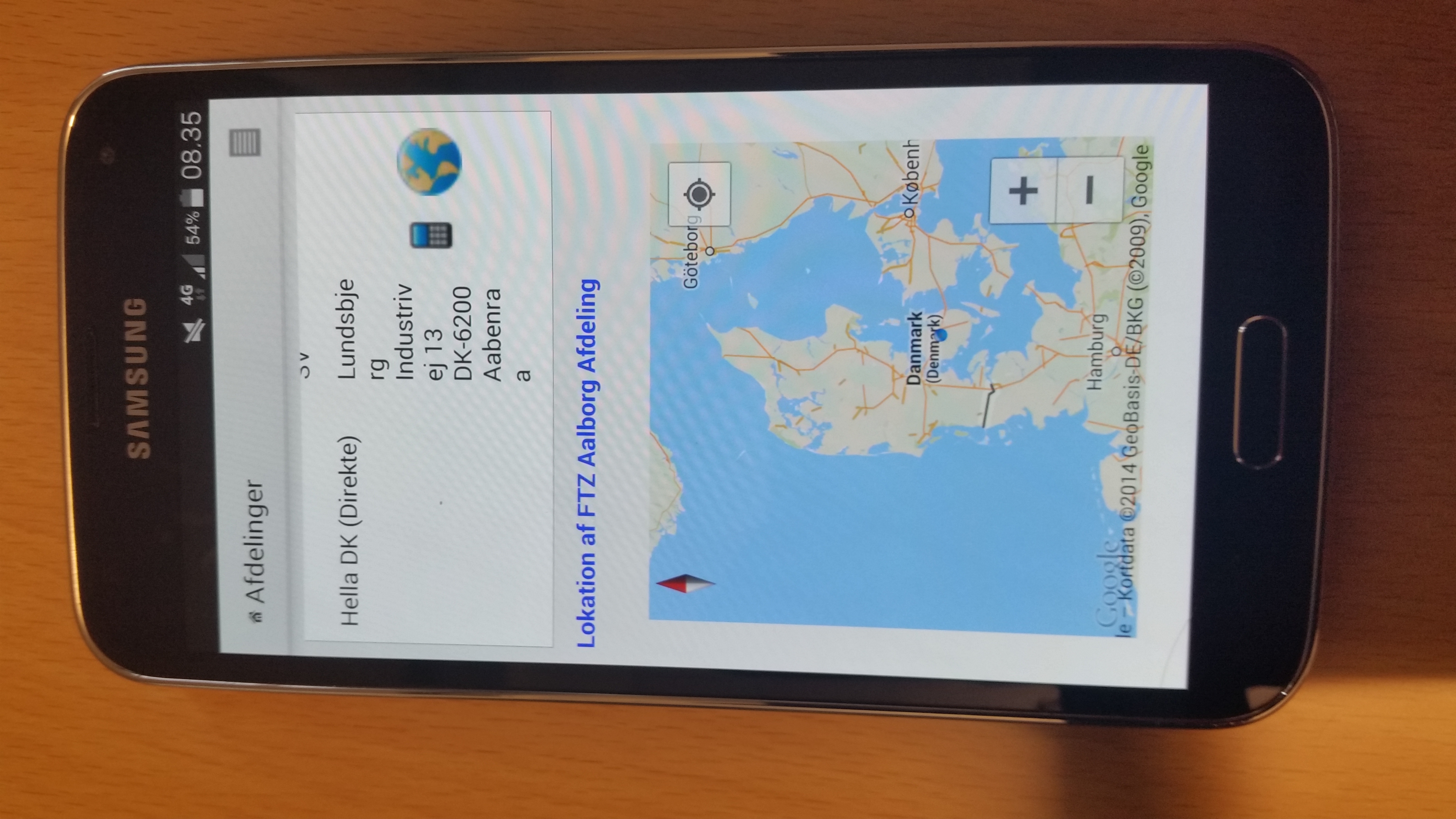

In my app (Lansa RDMLX) I have a list of departments. if I select one of the departments it is shown on a map with a pin and my position is shown with a blue dot. this works fine on Iphone and Ipad. We are right now testing this app on adroid. If I select a department it does not show the pin. It is only show my position with a blue dot. The device is a Samsung Galaxsy S5, Modelnumber : SM-G900F with Android Version : 4.4.2

Probably Google Maps (which is what Android uses) doesn't recognise the address?
Did you try with other addresses? Did you ever manage to get any pins at all?
Have you compared with say the "Location Tables" example from the standard LANSA demo? (Programming Examples >> Advanced Examples >> Location Tables) - do you get any pins with this example? If yes - then Google map can't recognise the address you provided (Apple Maps does recognise since it works on iOS).
Provide us with one of the addresses (divided into parts, the way you set them in the code) and the RDMLX code that sets the addresses.
