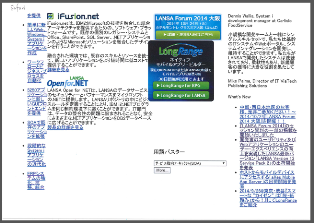

A web view is embedded in a form view,and pdf is displayed in that web view.The target pdf is in Landscape.
When ShowNavigationToolBar is set to True, Print option will be shown.
When selecting print option on NavigationToolBar in web view, the pdf is printed in portrait orientation.
When showing the same pdf in Safari and printing it, the pdf is printed in Landscape Mode.
Printed from Safari
Printed from Safari

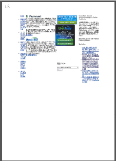

Printed from LongRange
Is there any way to control the orientation in printing pdf from LongRange web view?
