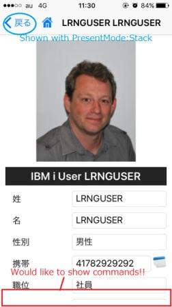

I'd like to display commands on formview which is shown with Presentmode:Stack on RPG online form.
Is it possible to do so in some way?
In PGM1:
LRNG_Using('/RunOperation');
LRNG_SetProperties('Type: PERFORMACTION'
: 'PGM:PGM2'
: 'PresentMode:Stack'
: 'PARAM%1: 1121111'
: 'PARAM%2: Tokyo');
LRNG_ENDUSING();
This will perform PGM2 with PresentMode:stack.
PGM2 screen will be shown with PresentMode:Stack,but commands are not shown even if we create formview "PGM2" with commands set in LongRange studio.
Is there any way to show commands on formview shown with PresentMode:Stack?
Any advice will be appreciated.

- IMG_6554.jpg (24.15 KiB) Viewed 3489 times

Re: [RPG]Display commands on Presentmode:Stack formview
Hi Tony,
Thank you for your advice.
I have some questions regarding your reply.
1)Is 'OpenForm' operation available in Online form?
Also, can we pass/get parameters between formviews when using 'OpenForm' operation?
2) I have tried 'LRNG_SwitchToFormView' with PerformAction.
However, no commands are displayed. Can you display it on English environment?
FYI: I have wrote as follows;
LRNG_SwitchToFormView('LRDEMO0001'); ---> LRDEMO0001 is the formview to switch to.
: 'PGM:LRDEMO001'
: 'PARAM%2: 東京都 ');
LRNG_ENDUSING();
LRNG_SwitchToFormView('HLDEMO005'); ---> HLDEMO005 is the formview to switch back to.
IsNewForm = False;
: 'PGM:LRDEMO001'
: 'PARAM%2: 東京都 ');
LRNG_ENDUSING();
IsNewForm = False;
1) Yes you can use it to open online forms, but you can't pass parameters.
2) You have to put the LRNG_SwitchToFormView in your LRDEMO001 program (not in the calling program).
- Posts: 268
Hi Tony,
2)
I have confirmed the commands are shown!
Thank you!!
2)
Thank you!!
