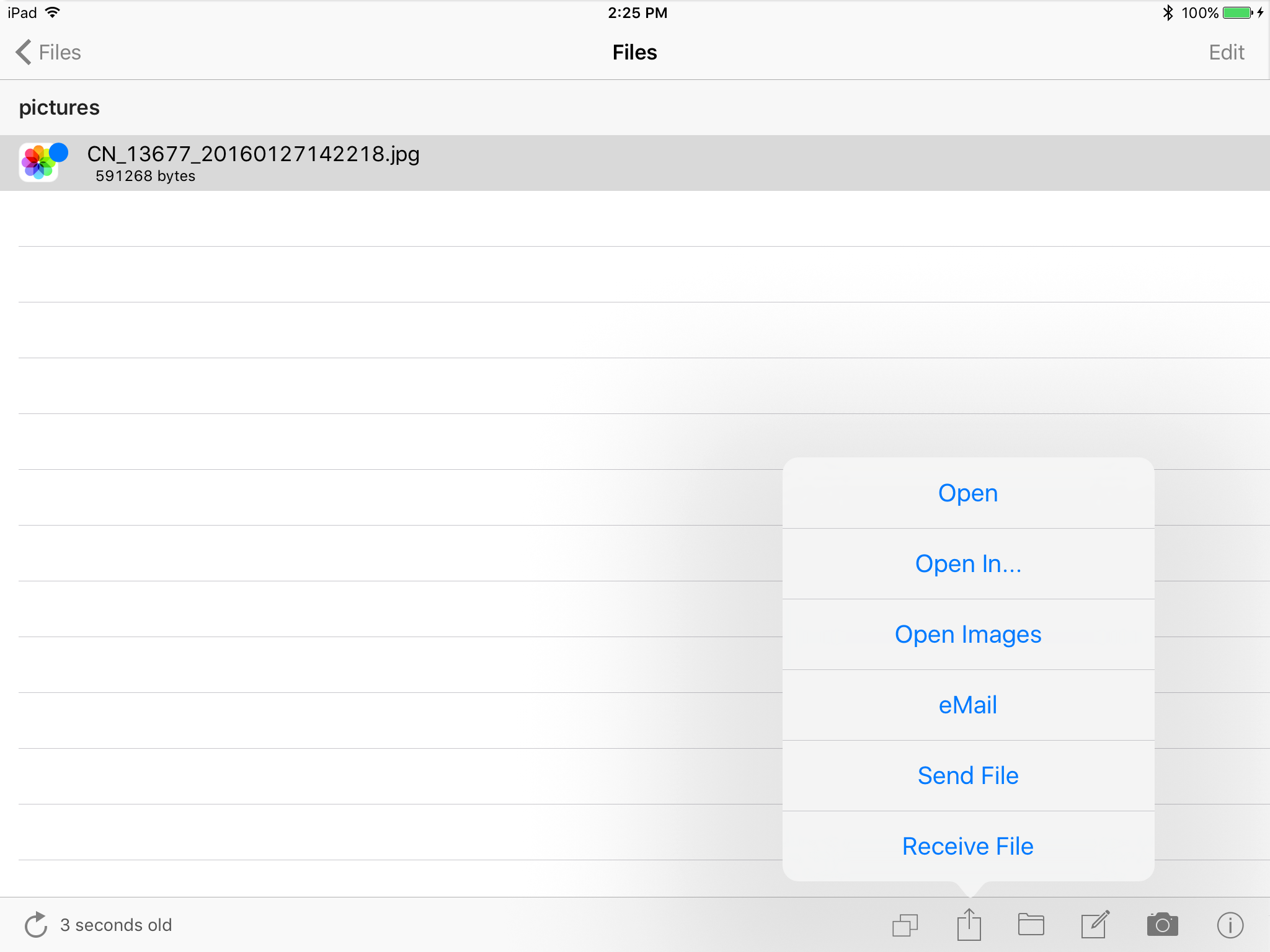

I think the second option would work best...so long as it can be controlled by the JavaScript API. What would work best for me would be something like the functionality in the LongReach app (in the attached screenshot).
My use case is downloading Sales/Marketing material for a mobile salesforce...for use offline. Currently the app is 100% HTML5/JavaScript, using the JavaScript API and starting in a single webview.
- screenshot.png (429.38 KiB) Viewed 6804 times

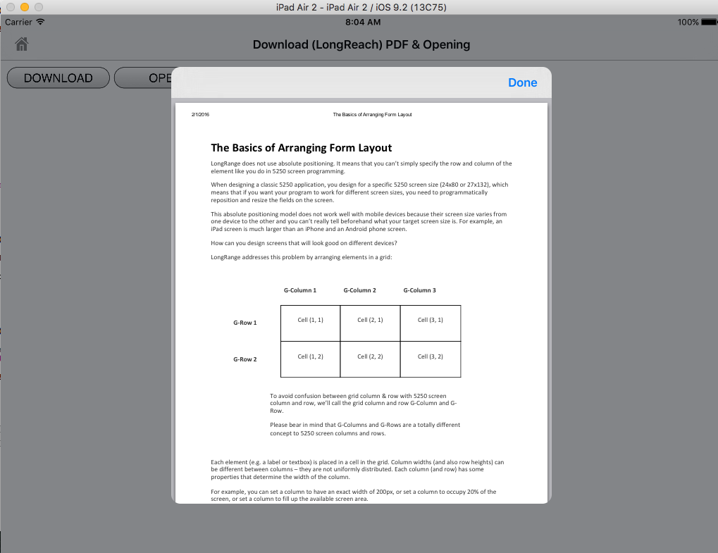

Yes you are right in that the iframe method wouldn't work as LR would open the PDF in the web view itself instead of in the iframe. This is due to the way we handle navigation and currently there is no plan to make iframes work in LongRange, I apologise for the misinformation.
However, the "window.open" method should work. I have done a simple test of downloading a PDF using the FileTransfer (LongReach) APIs, and opening that using window.open - that seemed to work for me.
Please see the attached screenshot (the PDF opens in a window).
Here is the code that I use to open the PDF:
Let me know how you go.
window.open("DownloadedContents/TestPDF.pdf");
