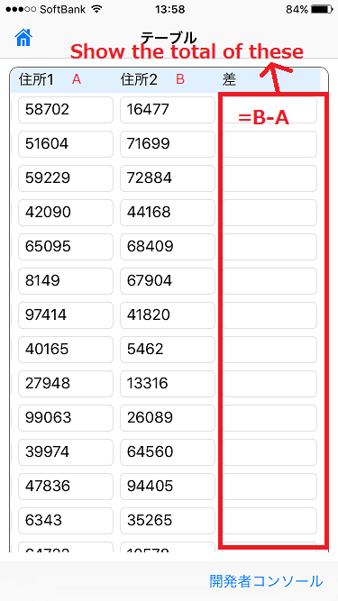

I have asked how to show the result of calculation of offline table.
http://longrange.lansa.com.au/viewtopic.php?f=11&t=507
I would like to get the sum of these result and show it as a label on the offline formview.
The vaule should be get when button is clicked on the formview.
Is it possible to implement with offline formveiw?
If yes, could you please let me know how to?

If I understand your question correctly, the difference between this and your previous scenario is the trigger, when the calculated values will be displayed, this time the values will be calculated when a button is touched?
If that's the case, you can start with no binding for the calculated column, then as the user touched the "calculate" button, you'd use ECL to change the binding of the calculated column to SELECT number2 - number1.

Hi Tony,
Thank you for your reply.
I would like to sum up these results when button is clicked.
Mytable.Row%1.Col%4 = 100
Mytable.Row%2.Col%4 = 200
Mytable.Row%3.Col%4 = 300
Mytable.Row%4.Col%4 = 400
Then I would liek to show the result of (100 + 200 + 300 + 400 ), i.e. 1000 as a label above the table.
I don't know how to do it with offline form...

There is a solution where the total would be calculated automatically without the end-user having to press a button.
Because the calculated column is NUMBER2 - NUMBER1, so the sum of that calculated values would be SUM(NUMBER2) - SUM(NUMBER1)
Let's say that your table on the form is showing values from a table called VALUES, you can get the sum of the calculated field using this SQL statement:
You just need to bind the label that would show the total to this SQL like so:
select sum(NUMBER2) - sum(NUMBER1) from VALUES

Hi Tony,
The user's requirement is a bit more complex, but I think I can make it work based on your advice.
Thank you!
