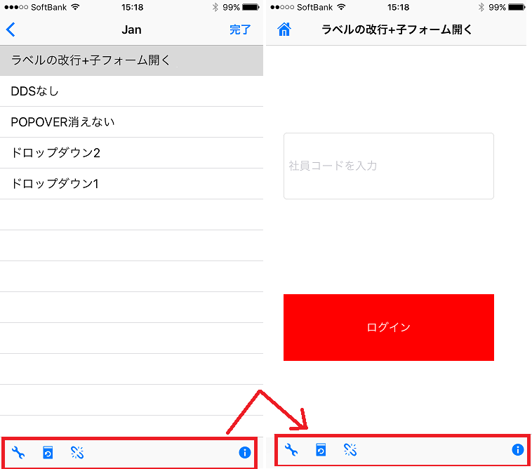

Is there any way to keep showing system menus(configure profiles, close forms, product info) all the time in LongRange client app?
I believe these are shown in the bottom of navigation menus, but I would like to show these in the bottom of snap-ins too.

- system menus.png (30.94 KiB) Viewed 4011 times

Sorry, we need to show these system menus "ALL THE TIME", but would like to know how to show it programmatically if there's a way.

Megumi,
There is no way to exactly do what you want, but with some effort, you can achieve the required functionality.
Your form programs can be written in such a way that would include a panel of buttons at the bottom (the buttons are the system menu items, such as Settings, Refresh etc).
You would then use the ClientCommand operation to invoke the required operations (Settings, Refresh etc).
LRNG_Using('/Form.Fields.SettingsButton.OnClick.Operation');
LRNG_SetProperty('Type' : 'ClientCommand');
LRNG_SetProperty('Command' : 'Settings');
LRNG_EndUsing();
