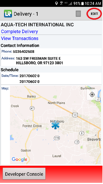

I misspoke when I said system menu. I meant more of a form level menu. What I'm trying to do is limit the form level menu options based upon a mode. If the user is in a maintenance type mode, then options like edit/save would be visible. If they are in an inquiry type mode, then save/edit would be invisible.
I've attached a screen shot and circled exactly what I'm trying to hide. Sorry for the wild goose chase.
Re: [RPG] Offline System Menus
Use Form.Menus instead of System.Menus for form level menu items.
