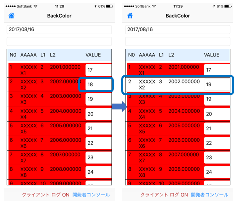

Setting BackColor: Red to table rows as default and setting BackColor:White to a row when row value is changed, it works as expected. The backcolor of the target row will be turned white.
CALLP      LRNG_ASSIGNSTRTOPROP
           ('RED' : /FORM.FIELDS.LIST1.ROW%' +
              %CHAR(LOCAL.INDEX) + '.BACKCOLOR')
and
           ('WHITE' : /FORM.FIELDS.LIST1.ROW%' +

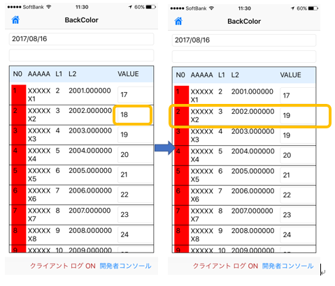

However, when setting BackColor of some content of the row(not the whole columns of the row) and setting BackColor:White to the row when row value is changed, the colored BackColor won't be turned white.
              %CHAR(LOCAL.INDEX) + '.NO.BACKCOLOR')
and
Is this an intended behavior?
Do we need to set BackColor:White to each content if you've set BackColor to some contents, not the whole contents of the row?

Yes, it's an expected behaviour.
You need to set BackColor:White for each content to change its background color.
The following code will change the background color to white
Thanks
Jason
