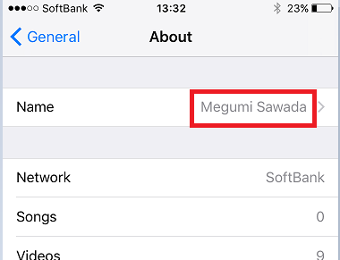

Is it possible to get Device Name from LongRange?

Hi Jason,
Thank you for your reply.
The customer uses iOS.
Could you please let me know how we can retreive Device name on iOS?
It's not in SystemInfo...
