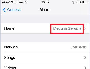

Hi Jason,
Thank you for your reply.
The customer uses iOS.
Could you please let me know how we can retreive Device name on iOS?
It's not in SystemInfo...
