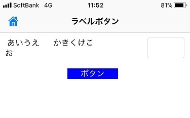

I'm using a label element with Onclick property so that I can use it as a button.
I have set Layout.Width: 100 as well as Layout.cols: -1 and Textalign: center, and I thought it would result as follows;

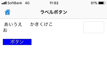

However the result is as follows;
How can I acheieve what I expect (the first pic)?

Re: [RPG]Label button textalign:center with specifying width
Post by jasonzhou »
Please try the following code
     A                                 26 20HTML('<<FORM3>>
     A                                      Type: Form
     A                                      LAYOUT.COLS: -1
     A                                      Grid.HAlign: Center
     A                                      Fields.Label
     A                                      (
     A                                          Type : LABEL
     A                                          BACKCOLOR: BLUE
     A                                          COLOR:WHITE
     A                                          TEXT : Push
     A                                          LAYOUT.WIDTH : 100
     A                                          TEXTALIGN: CENTER
     A                                          ONCLICK: BTN1CLK
     A                                      )
     A                                      ')
Hi Jason,
It works!
OK, then, I need to use subform to do this...
