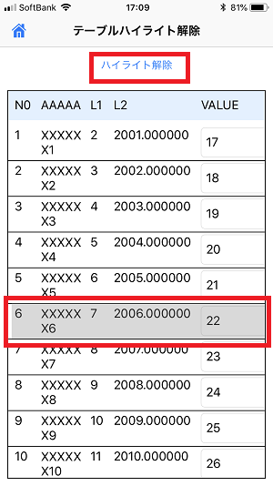

Is there any way to reset Highlight row when button (above the table) is clicked?
I can reset highlight row by setting HighlightCurrentRow to OFF when button is clicked.
However, it will stop showing highlight row afterwards.
I would like to set table to be highlighted again when one of table row is clicked again.
It seems none of the following way acheives the expected result.
-Retreive the current row id and set ROW%N.Highlight to OFF
-Set table's CurrentRowID to null
-Set table's CurrentRowID to non-existing value
-Set table's HighlightCurrentRow to OFF and ON again
I appreciate your kind advice!

The Row.HighLight property can implement this. The implementation steps are:
• Set HighlightCurrentRow to False
• Set Row.HighLight to True when current row is touched
• Set all Row.HighLight properties to False when reset highlight
Please see the following demo code:
// Highlight touched row
Begsr ON_ROW_TOUCHED;
    // Clear previously highlighted row
    For Local.Index = 1 to 50;
        LRNG_Using('/Form.Fields.TABLE1.ROW' : Idx(Local.Index));
        LRNG_SetProperty('HighLight' : 'False');
    endfor;
    // Get Current row id
    RowId = LRNG_GetPropAsStr('/Form.Fields.TABLE1.CurrentRowID');
    // Highlight selected row
    HighLightedRow = '/Form.Fields.TABLE1.ROW%' + RowId + '.HighLight';
    LRNG_SetProperty(HighLightedRow: 'True');
Endsr;
// clear all highlights when click clear button
Begsr ON_CLEAR_HIGHLIGHT_BUTTON_CLICKED;
    // Clear all highlighted rows
    endfor;
Endsr;
