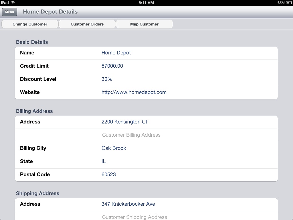

The code for the screen shot above is as follows,
* COMPONENT: STD_PANL
Function Options(*DIRECT)
Begin_Com Role(*EXTENDS #LRNG_FORM)
* Includes
Define_Com Class(#IOSLOOKV2) Name(#IOS2)
Define_Com Class(#prim_nmbr) Name(#pageSize) Value(20)
Define_Com Class(#prim_nmbr) Name(#endPage)
Define_Com Class(#PRIM_NMBR) Name(#W$LORD)
* Work Objects
Define_Com Class(#PRIM_ALPH) Name(#actionValue)
Define_Com Class(#PRIM_ALPH) Name(#W$CSTV)
Define Field(#retcode) Type(*char) Length(2)
* Group_bys
Group_By Name(#custData) Fields(#LTCCUSTNM #LTCCUSTEM #LTCCUSTB1 #LTCCUSTB2 #LTCCUSTBC #LTCCUSTBS #LTCCUSTBZ #LTCCUSTS1 #LTCCUSTS2 #LTCCUSTSC #LTCCUSTSS #LTCCUSTSZ #LTCCUSTPC #LTCCUSTPP #LTCCUSTPR #LTCCUSTPA #LTCCUSTCL #LTCCUSTCB #LTCDISCCD #LTCCUSTG #LTCCUSTWS)
* Form Names
Define_Com Class(#PRIM_ALPH) Name(#top)
Define_Com Class(#PRIM_ALPH) Name(#content)
Define_Com Class(#PRIM_ALPH) Name(#basicbox)
Define_Com Class(#PRIM_ALPH) Name(#billtobox)
Define_Com Class(#PRIM_ALPH) Name(#shiptobox)
Define_Com Class(#PRIM_ALPH) Name(#commsbox)
* LTCLRSD00 - Mainline
Mthroutine Name(HandleRequest) Options(*REDEFINE)
* Handle currently requested action (if any)
* Always set the USING Element to /Form.Fields at the start
#Com_Owner.Using Element('/Form.Fields')
* And Get the Current Top and Content
#COM_OWNER.Get_SharedState Variablename(currentTop) Value(#top)
#COM_OWNER.Get_SharedState Variablename(currentContent) Value(#content)
* Values
#Com_Owner.Get_SharedState Variablename('currentCustomer') Value(#W$CSTV)
If (#COM_OWNER.RequestACTION.Contains( '_' ))
#actionValue := (#COM_OWNER.RequestACTION).Substring( 1 ((#COM_OWNER.RequestACTION).PositionOf( '_' ) - 1) )
Else
#actionValue := #COM_OWNER.RequestACTION
Endif
Case Of_Field(#actionValue)
When Value_Is(= actionCustomer)
#COM_Owner.SwitchRequestPROGRAM := 'LTCLRSD01'
#COM_Owner.SwitchRequestACTION := 'DEFAULT'
When Value_Is(= actionOrders)
#COM_Owner.SwitchRequestPROGRAM := 'LTCLRSD02'
When Value_Is(= actionSave)
#COM_OWNER.IsNewForm := false
#com_owner.handleSave
When Value_Is(= actionMapCustomer)
* Do the switch
#COM_Owner.SwitchRequestPROGRAM := 'LTCLTSD05'
Otherwise /* Default */
#COM_OWNER.IsNewForm := true
#COM_OWNER.showDetails()
Endcase
* Always Set Current Top and Content
#COM_OWNER.Set_SharedState Variablename(currentTop) Value(#top)
#COM_OWNER.Set_SharedState Variablename(currentContent) Value(#content)
* Values
#Com_Owner.Set_SharedState Variablename('currentCustomer') Value(#W$CSTV)
Endroutine
Mthroutine Name(showDetails)
Fetch Fields(#custData) From_File(LTCCUST) With_Key(#W$CSTV)
* Init FormView
#IOS2.initFormView Formview(#COM_OWNER) Maintitle(#LTCCUSTNM + ' Details') Topbarheight(40) Topbarfullname(#top) Contentfullname(#content)
* Set Nav Buttons
#com_owner.set_button Layout_Col(1) Layout_Row(1) Name(#top + '.fields.topButton1') Text('Change Customer') Border_Cornerradius(0) Color('&4f5458') Layout_Height(30) Layout_Width(200) Buttonfacecolor('&f5f5f5') Onclick(actionCustomer)
#com_owner.set_button Layout_Col(2) Layout_Row(1) Name(#top + '.fields.topButton2') Text('Customer Orders') Border_Cornerradius(0) Color('&4f5458') Layout_Height(30) Layout_Width(200) Buttonfacecolor('&f5f5f5') Onclick(actionOrders)
#com_owner.set_button Layout_Col(3) Layout_Row(1) Name(#top + '.fields.topButton3') Text('Map Customer') Border_Cornerradius(0) Color('&4f5458') Layout_Height(30) Layout_Width(200) Buttonfacecolor('&f5f5f5') Onclick(actionMapCustomer)
#IOS2.initSubForm Formview(#COM_OWNER) Subform(#content)
* Setup Groupboxs on Content Form
#COM_OWNER.Set_Label Name(#content + '.fields.space1') Layout_Row(1) Layout_Col(2) Layout_Height(25)
#COM_OWNER.Set_Label Name(#content + '.fields.instruction1') Layout_Row(2) Layout_Col(2) Text('Basic Details') Font_Size(18) Color('&4A566C') Font_Bold(true) Padding(5)
#IOS2.createGroupBox Formview(#COM_OWNER) Parent(#content) Name(basicBox) Boxfullname(#basicbox) Layoutrow(3)
#COM_OWNER.Set_Label Name(#content + '.fields.space2') Layout_Row(4) Layout_Col(2) Layout_Height(25)
#COM_OWNER.Set_Label Name(#content + '.fields.instruction2') Layout_Row(5) Layout_Col(2) Text('Billing Address') Font_Size(18) Color('&4A566C') Font_Bold(true) Padding(5)
#IOS2.createGroupBox Formview(#COM_OWNER) Parent(#content) Name(billtoBox) Boxfullname(#billtobox) Layoutrow(6)
#COM_OWNER.Set_Label Name(#content + '.fields.space3') Layout_Row(7) Layout_Col(2) Layout_Height(25)
#COM_OWNER.Set_Label Name(#content + '.fields.instruction3') Layout_Row(8) Layout_Col(2) Text('Shipping Address') Font_Size(18) Color('&4A566C') Font_Bold(true) Padding(5)
#IOS2.createGroupBox Formview(#COM_OWNER) Parent(#content) Name(shiptoBox) Boxfullname(#shiptobox) Layoutrow(9)
#COM_OWNER.Set_Label Name(#content + '.fields.space4') Layout_Row(10) Layout_Col(2) Layout_Height(25)
#COM_OWNER.Set_Label Name(#content + '.fields.instruction4') Layout_Row(11) Layout_Col(2) Text('Contact Information') Font_Size(18) Color('&4A566C') Font_Bold(true) Padding(5)
#IOS2.createGroupBox Formview(#COM_OWNER) Parent(#content) Name(commsBox) Boxfullname(#commsbox) Layoutrow(12)
* Add Elements to Basic
#IOS2.setGroupBoxRow Formview(#COM_OWNER) Name(username) Groupbox(#basicbox) Elementtype(Textbox) Labeltext('Name') Placeholder('Customer Name') Layoutrow(1) Value(#ltccustnm)
#IOS2.setGroupBoxRow Formview(#COM_OWNER) Groupbox(#basicbox) Elementtype(divider) Layoutrow(2)
#IOS2.setGroupBoxRow Formview(#COM_OWNER) Name(creditlimit) Groupbox(#basicbox) Elementtype(Textbox) Labeltext('Credit Limit') Placeholder('0.00') Layoutrow(3) Value(#ltccustcl.asstring)
#IOS2.setGroupBoxRow Formview(#COM_OWNER) Groupbox(#basicbox) Elementtype(divider) Layoutrow(4)
#IOS2.setGroupBoxRow Formview(#COM_OWNER) Name(discount) Groupbox(#basicbox) Elementtype(Textbox) Labeltext('Discount Level') Placeholder('00%') Layoutrow(5) Value(#ltcdisccd)
#IOS2.setGroupBoxRow Formview(#COM_OWNER) Groupbox(#basicbox) Elementtype(divider) Layoutrow(6)
#IOS2.setGroupBoxRow Formview(#COM_OWNER) Name(website) Groupbox(#basicbox) Elementtype(Textbox) Labeltext('Website') Placeholder('http://www.company.com.au') Layoutrow(7) Value(#ltccustws)
#IOS2.setGroupBoxRow Formview(#COM_OWNER) Groupbox(#basicbox) Elementtype(divider) Layoutrow(8)
* Add Elements to BillTo
#IOS2.setGroupBoxRow Formview(#COM_OWNER) Name(address1) Groupbox(#billtobox) Elementtype(Textbox) Labeltext('Address') Placeholder('Customer Billing Address') Layoutrow(1) Value(#ltccustb1)
#IOS2.setGroupBoxRow Formview(#COM_OWNER) Groupbox(#billtobox) Elementtype(divider) Layoutrow(2)
#IOS2.setGroupBoxRow Formview(#COM_OWNER) Name(address2) Groupbox(#billtobox) Elementtype(Textbox) Labeltext('') Placeholder('Customer Billing Address') Layoutrow(3) Value(#ltccustb2)
#IOS2.setGroupBoxRow Formview(#COM_OWNER) Groupbox(#billtobox) Elementtype(divider) Layoutrow(4)
#IOS2.setGroupBoxRow Formview(#COM_OWNER) Name(city) Groupbox(#billtobox) Elementtype(Textbox) Labeltext('Billing City') Placeholder('Billing City') Layoutrow(5) Value(#ltccustbc)
#IOS2.setGroupBoxRow Formview(#COM_OWNER) Groupbox(#billtobox) Elementtype(divider) Layoutrow(6)
#IOS2.setGroupBoxRow Formview(#COM_OWNER) Name(state) Groupbox(#billtobox) Elementtype(Textbox) Labeltext('State') Placeholder('Billing State') Layoutrow(7) Value(#ltccustbs)
#IOS2.setGroupBoxRow Formview(#COM_OWNER) Groupbox(#billtobox) Elementtype(divider) Layoutrow(8)
#IOS2.setGroupBoxRow Formview(#COM_OWNER) Name(postcode) Groupbox(#billtobox) Elementtype(Textbox) Labeltext('Postal Code') Placeholder('Billing Postal Code') Layoutrow(9) Value(#ltccustbz)
#IOS2.setGroupBoxRow Formview(#COM_OWNER) Groupbox(#billtobox) Elementtype(divider) Layoutrow(10)
* Add Elements to ShipTo
#IOS2.setGroupBoxRow Formview(#COM_OWNER) Name(address1) Groupbox(#shiptobox) Elementtype(Textbox) Labeltext('Address') Placeholder('Customer Shipping Address') Layoutrow(1) Value(#ltccusts1)
#IOS2.setGroupBoxRow Formview(#COM_OWNER) Groupbox(#shiptobox) Elementtype(divider) Layoutrow(2)
#IOS2.setGroupBoxRow Formview(#COM_OWNER) Name(address2) Groupbox(#shiptobox) Elementtype(Textbox) Labeltext('') Placeholder('Customer Shipping Address') Layoutrow(3) Value(#ltccusts2)
#IOS2.setGroupBoxRow Formview(#COM_OWNER) Groupbox(#shiptobox) Elementtype(divider) Layoutrow(4)
#IOS2.setGroupBoxRow Formview(#COM_OWNER) Name(city) Groupbox(#shiptobox) Elementtype(Textbox) Labeltext('Billing City') Placeholder('Shipping City') Layoutrow(5) Value(#ltccustsc)
#IOS2.setGroupBoxRow Formview(#COM_OWNER) Groupbox(#shiptobox) Elementtype(divider) Layoutrow(6)
#IOS2.setGroupBoxRow Formview(#COM_OWNER) Name(state) Groupbox(#shiptobox) Elementtype(Textbox) Labeltext('State') Placeholder('Shipping State') Layoutrow(7) Value(#ltccustss)
#IOS2.setGroupBoxRow Formview(#COM_OWNER) Groupbox(#shiptobox) Elementtype(divider) Layoutrow(8)
#IOS2.setGroupBoxRow Formview(#COM_OWNER) Name(postcode) Groupbox(#shiptobox) Elementtype(Textbox) Labeltext('Postal Code') Placeholder('Shipping Postal Code') Layoutrow(9) Value(#ltccustsz)
#IOS2.setGroupBoxRow Formview(#COM_OWNER) Groupbox(#shiptobox) Elementtype(divider) Layoutrow(10)
* Add Elements to Comms
#IOS2.setGroupBoxRow Formview(#COM_OWNER) Name(service) Groupbox(#commsbox) Elementtype(Textbox) Labeltext('Customer Service') Placeholder('+61 2 9999 9999') Layoutrow(1) Value(#ltccustpc)
#IOS2.setGroupBoxRow Formview(#COM_OWNER) Groupbox(#commsbox) Elementtype(divider) Layoutrow(2)
#IOS2.setGroupBoxRow Formview(#COM_OWNER) Name(purchasing) Groupbox(#commsbox) Elementtype(Textbox) Labeltext('Purchasing') Placeholder('+61 2 9999 9999') Layoutrow(3) Value(#ltccustpp)
#IOS2.setGroupBoxRow Formview(#COM_OWNER) Groupbox(#commsbox) Elementtype(divider) Layoutrow(4)
#IOS2.setGroupBoxRow Formview(#COM_OWNER) Name(ar) Groupbox(#commsbox) Elementtype(Textbox) Labeltext('Recievable') Placeholder('+61 2 9999 9999') Layoutrow(5) Value(#ltccustpr)
#IOS2.setGroupBoxRow Formview(#COM_OWNER) Groupbox(#commsbox) Elementtype(divider) Layoutrow(6)
#IOS2.setGroupBoxRow Formview(#COM_OWNER) Name(ap) Groupbox(#commsbox) Elementtype(Textbox) Labeltext('Payable') Placeholder('+61 2 9999 9999') Layoutrow(7) Value(#ltccustpa)
#IOS2.setGroupBoxRow Formview(#COM_OWNER) Groupbox(#commsbox) Elementtype(divider) Layoutrow(8)
#IOS2.setGroupBoxRow Formview(#COM_OWNER) Name(email) Groupbox(#commsbox) Elementtype(Textbox) Labeltext('Email') Placeholder('[email protected]') Layoutrow(9) Value(#ltccustem)
#IOS2.setGroupBoxRow Formview(#COM_OWNER) Groupbox(#commsbox) Elementtype(divider) Layoutrow(10)
* Button under Group
#IOS2.createButton Formview(#COM_OWNER) Parent(#content) Name(signinButton) Layoutrow(14) Text('Save') Color('black') Layoutheight(50) Onclickaction(actionSave)
Endroutine
Mthroutine Name(handleSave)
Define_Com Class(#prim_alph) Name(#ltccustcla)
* Get Values
#IOS2.getElementValue Namedpath('content,basicbox,username') Formview(#COM_OWNER) Value(#ltccustnm)
#IOS2.getElementValue Namedpath('content,basicbox,creditlimit') Formview(#COM_OWNER) Value(#ltccustcla)
#ltccustcl := #ltccustcla.asnumber
#IOS2.getElementValue Namedpath('content,basicbox,discount') Formview(#COM_OWNER) Value(#LTCDISCCD)
#IOS2.getElementValue Namedpath('content,basicbox,website') Formview(#COM_OWNER) Value(#ltccustws)
#IOS2.getElementValue Namedpath('content,billtobox,address1') Formview(#COM_OWNER) Value(#ltccustb1)
#IOS2.getElementValue Namedpath('content,billtobox,address2') Formview(#COM_OWNER) Value(#ltccustb2)
#IOS2.getElementValue Namedpath('content,billtobox,city') Formview(#COM_OWNER) Value(#ltccustbc)
#IOS2.getElementValue Namedpath('content,billtobox,state') Formview(#COM_OWNER) Value(#ltccustbs)
#IOS2.getElementValue Namedpath('content,billtobox,postcode') Formview(#COM_OWNER) Value(#ltccustbz)
#IOS2.getElementValue Namedpath('content,shiptobox,address1') Formview(#COM_OWNER) Value(#ltccusts1)
#IOS2.getElementValue Namedpath('content,shiptobox,address2') Formview(#COM_OWNER) Value(#ltccusts2)
#IOS2.getElementValue Namedpath('content,shiptobox,city') Formview(#COM_OWNER) Value(#ltccustsc)
#IOS2.getElementValue Namedpath('content,shiptobox,state') Formview(#COM_OWNER) Value(#ltccustss)
#IOS2.getElementValue Namedpath('content,shiptobox,postcode') Formview(#COM_OWNER) Value(#ltccustsz)
#IOS2.getElementValue Namedpath('content,commsbox,service') Formview(#COM_OWNER) Value(#ltccustpc)
#IOS2.getElementValue Namedpath('content,commsbox,purchasing') Formview(#COM_OWNER) Value(#ltccustpp)
#IOS2.getElementValue Namedpath('content,commsbox,ar') Formview(#COM_OWNER) Value(#ltccustpr)
#IOS2.getElementValue Namedpath('content,commsbox,ap') Formview(#COM_OWNER) Value(#ltccustpa)
#IOS2.getElementValue Namedpath('content,commsbox,email') Formview(#COM_OWNER) Value(#ltccustem)
* Update File
Update Fields(#custData) In_File(ltccust) With_Key(#W$CSTV) Io_Error(*NEXT) Val_Error(*NEXT)
Endroutine
End_Com

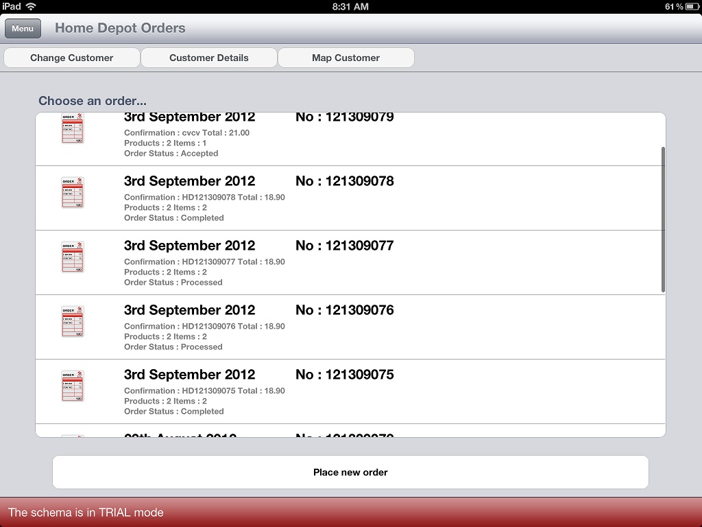

Pascal,
See the updated post, it includes the right arrow for the old code and example.
Here is another example screen
Cheers
Greg
Cheers
Greg

Hi Greg,
This looks great. Have you got the example source for the second screen so we can embed a form as we are struggling to get this to work,
Thanks
Andy
Thanks
Andy
GregSippel
- Posts: 5
- Joined: Mon May 14, 2012 7:32 am
Re: Resuable Part for Generic iOS screens - UPDATED (RDMLX)
Andy,
No worries, here is the code for this reusable part. The code in bold covers the building of the list and the add more entries functionality
* Includes
Define_Com Class(#LRTHMS001) Name(#THEME)
Define_Com Class(#PRIM_ALPH) Name(#APPTHEME)
Define_Com Class(#PRIM_ALPH) Name(#THEMENAME)
* Work Objects
* Group_bys
Group_By Name(#orderData) Fields(#LTCOHDRNO #LTCOHDRTL #LTCOHDRIT #LTCOHDRPR #LTCOHDRCN #LTCOHDRDT #LTCOHDROH #LTCOHDRPD #LTCOHDRDD)
* Form Names
#COM_OWNER.Set_SharedState Variablename('LTCLR_SALES_LASTRP') Value(*COMPONENT)
#COM_OWNER.Set_SharedState Variablename('LTCLR_SALES_LASTSN') Value(LTC_SALES_ORDERS)
#COM_OWNER.Get_SharedState Variablename(LTCLR_SALES_currentTop) Value(#top)
#COM_OWNER.Get_SharedState Variablename(LTCLR_SALES_currentContent) Value(#content)
* Hold onto Theme
#Com_Owner.Get_SharedState Variablename('LTCLRDEMO_THEME') Value(#THEMENAME)
#APPTHEME := 'LTCLRDEMO_THEME_' + #THEMENAME
Else
Endif
#Com_Owner.SwitchToFormView Named(LTC_SALES_CUST)
When Value_Is(= actionSalesGraph)
#COM_Owner.SwitchRequestPROGRAM := 'LTCLTSD17'
#Com_Owner.SwitchToFormView Named(LTC_SALES_CUSTGRPH)
When Value_Is(= actionMore)
* Get Needed Values
#Com_Owner.Get_SharedStateNum Variablename('LTCLR_SALES_lastOrder') Value(#W$LORD)
#Com_Owner.Get_SharedStateNum Variablename('LTCLR_SALES_lastIndex') Value(#LISTCOUNT)
#COM_OWNER.showOrders()
When Value_Is(= actionOrder)
#COM_OWNER.Set_SharedState Variablename('LTCLR_SALES_currentOrder') Value((#COM_OWNER.RequestACTION).Substring( ((#COM_OWNER.RequestACTION).PositionOf( '_' ) + 1) ))
#COM_OWNER.Set_SharedState Variablename(LTCLR_SALES_savedOrder) Value(*blank)
#COM_Owner.SwitchRequestPROGRAM := 'LTCLRSD18'
#Com_Owner.SwitchToFormView Named(LTC_SALES_VIEW)
When Value_Is(= actionNewOrder)
#COM_OWNER.Set_SharedState Variablename('LTCLR_SALES_currentOrder') Value('')
#COM_Owner.SwitchRequestPROGRAM := 'LTCLRSD03'
#Com_Owner.SwitchToFormView Named(LTC_SALES_ENTRY)
When Value_Is(= actionDetails)
#COM_Owner.SwitchRequestPROGRAM := 'LTCLRSD04'
#Com_Owner.SwitchToFormView Named(LTC_SALES_DETS)
* Do the switch
#Com_Owner.SwitchToFormView Named(LTC_SALES_MAP)
* Set Needed Values
#listcount := 0
Endcase
#COM_OWNER.Set_SharedState Variablename(LTCLR_SALES_currentTop) Value(#top)
#COM_OWNER.Set_SharedState Variablename(LTCLR_SALES_currentContent) Value(#content)
Endroutine
Mthroutine Name(showOrders)
Define_Com Class(#prim_alph) Name(#ordersBox)
Define_Com Class(#prim_alph) Name(#orderRow)
Define_Com Class(#PRIM_alph) Name(#dateDate)
Define_Com Class(#PRIM_ALPH) Name(#statusText)
#Com_Owner.Get_SharedState Variablename('LTCLR_SALES_CURCUST') Value(#W$CSTV)
Fetch Fields(#ltccustnm) From_File(LTCCUST) With_Key(#W$CSTV)
* Init FormView
#IOS2.initFormView Formview(#COM_OWNER) Maintitle('Sales Central - ' + #LTCCUSTNM + ' Orders') Topbarheight(0) Topbarfullname(#top) Contentfullname(#content) Topbarbackcolor(#THEME.topbkgrdcolour<#APPTHEME>) Contentbackcolor(#THEME.contntbkgrdcolour<#APPTHEME>) Divdarkcolor(#THEME.topbkgrdcolour<#APPTHEME>) Divlightcolor(#THEME.topbkgrdcolour<#APPTHEME>)
* Set Nav Buttons
* #com_owner.set_button Layout_Col(1) Layout_Row(1) Name(#top + '.fields.topButton1') Text('Change Customer') Border_Cornerradius(0) Color(#THEME.topactioncolour<#APPTHEME>) Layout_Height(30) Layout_Width(200) Buttonfacecolor(#THEME.topactionbkcolour<#APPTHEME>) Onclick(actionCustomer)
* #com_owner.set_button Layout_Col(2) Layout_Row(1) Name(#top + '.fields.topButton2') Text('Customer Details') Border_Cornerradius(0) Color(#THEME.topactioncolour<#APPTHEME>) Layout_Height(30) Layout_Width(200) Buttonfacecolor(#THEME.topactionbkcolour<#APPTHEME>) Onclick(actionDetails)
* #com_owner.set_button Layout_Col(3) Layout_Row(1) Name(#top + '.fields.topButton3') Text('Map Customer') Border_Cornerradius(0) Color(#THEME.topactioncolour<#APPTHEME>) Layout_Height(30) Layout_Width(200) Buttonfacecolor(#THEME.topactionbkcolour<#APPTHEME>) Onclick(actionMapCustomer)
#IOS2.initSubForm Formview(#COM_OWNER) Subform(#content) Backcolor(#THEME.contntbkgrdcolour<#APPTHEME>)
#com_owner.Set_Form Name(#content) Grid_Row_N(1) Grid_Row_Height(25)
#com_owner.Set_Form Name(#content) Grid_Row_N(2) Grid_Row_Height(30)
#com_owner.Set_Form Name(#content) Grid_Row_N(3) Grid_Row_Height(fill)
#com_owner.Set_Form Name(#content) Grid_Row_N(4) Grid_Row_Height(20)
* #com_owner.Set_Form Name(#content) Grid_Row_N(5) Grid_Row_Height(50)
#com_owner.Set_Form Name(#content) Grid_Row_N(6) Grid_Row_Height(20)
* Set Instruction Label
#COM_OWNER.Set_Label Name(#content + '.fields.instruction1') Layout_Row(2) Layout_Col(2) Text('Choose an order...') Font_Size(18) Color('&4A566C') Font_Bold(true) Padding(5)
* Setup Groupbox on Content Form
#IOS2.createGroupBox Formview(#COM_OWNER) Parent(#content) Name(orderBox) Layoutrow(3) Boxfullname(#ordersBox) Maxheight('475')
* Add Rows to Group by user
#endPage := #Listcount + #pageSize
Select Fields(#orderData) From_File(LTCOHDRV7) Where(#W$CSTV *EQ #ltccustid) With_Key(#W$CSTV #W$LORD) Nbr_Keys(*compute) Options(*STARTKEY)
Continue If(#W$LORD *EQ #ltcohdrno)
#LISTCOUNT := #LISTCOUNT + 1
* Fetch Data
* Set Row
#IOS2.setGroupBoxRow Formview(#COM_OWNER) Groupbox(#ordersBox) Elementtype(form) Name('orderRow_' + #listcount.asstring) Layoutrow(#listcount) Layoutheight(115) Objfullname(#orderRow)
#Com_owner.set_null Property(#orderRow)
#Com_owner.set_null Property(#orderRow + '.Fields.more1')
* Set Content of Row
* Image and Spacer
#COM_OWNER.Set_Image Name(#orderRow + '.fields.logo') Resource(ordericon.png) Layout_Col(1) Layout_Row(1) Layout_Rows(4) Layout_Width(80) Layout_Height(80) Padding(5) Ontouch('actionOrder_' + #ltcohdrno.asstring)
#COM_OWNER.Set_label Name(#orderRow + '.fields.space') Border_Color('white') Layout_Col(2) Layout_Row(1) Layout_Rows(4) Layout_Width(30) Onclick('actionOrder_' + #ltcohdrno.asstring)
* Main Text Row
#dateDate := #LTCOHDRDT.asdate( CCYYMMDD ).AsDisplayString( DDxxbMMMMMMMMMbCCYY )
#COM_OWNER.Set_Label Name(#orderRow + '.fields.title1') Text(#dateDate) Color(Black) Font_Bold(true) Font_Size(20) Layout_Col(3) Layout_Row(1) Layout_Height(28) Layout_Width(250) Onclick('actionOrder_' + #ltcohdrno.asstring)
#COM_OWNER.Set_Label Name(#orderRow + '.fields.title2') Text('No : ' + #ltcohdrno.asstring) Color(Black) Font_Bold(true) Font_Size(20) Layout_Col(4) Layout_Row(1) Layout_Height(28) Layout_Width(150) Onclick('actionOrder_' + #ltcohdrno.asstring)
If (#ltcohdroh *NE N)
#COM_OWNER.Set_Label Name(#orderRow + '.fields.title3') Text(HOLD) Color(red) Font_Bold(true) Font_Size(20) Layout_Col(5) Layout_Row(1) Layout_Height(28) Layout_Width(75) Onclick('actionOrder_' + #ltcohdrno.asstring)
Endif
* Following Rows
#COM_OWNER.Set_Label Name(#orderRow + '.fields.dataline1') Text('Confirmation : ' + #ltcohdrcn + ' Total : ' + #ltcohdrtl.asstring) Color(gray) Font_Bold(true) Font_Size(12) Layout_Col(3) Layout_Row(3) Layout_Height(15) Onclick('actionOrder_' + #ltcohdrno.asstring)
#COM_OWNER.Set_Label Name(#orderRow + '.fields.dataline2') Text('Products : ' + #ltcohdrpr.asstring + ' Items : ' + #ltcohdrit.asstring) Color(gray) Font_Bold(true) Font_Size(12) Layout_Col(3) Layout_Row(4) Layout_Height(15) Onclick('actionOrder_' + #ltcohdrno.asstring)
* Status Row
#statusText := 'Accepted'
If (#ltcohdrpd *NE *zero)
#statusText := 'Packed'
Endif
If (#ltcohdrdd *NE *zero)
#statusText := 'Deliveried'
Endif
#COM_OWNER.Set_Label Name(#orderRow + '.fields.dataline3') Text('Order Status : ' + #statusText) Color(gray) Font_Bold(true) Font_Size(12) Layout_Col(3) Layout_Row(5) Layout_Height(15) Onclick('actionOrder_' + #ltcohdrno.asstring)
* Set Divider
#IOS2.setGroupBoxRow Formview(#COM_OWNER) Elementtype(divider) Groupbox(#ordersBox) Layoutrow(#listcount)
#std_flag := M
Leave If(#listcount *EQ #endPage)
#std_flag := *blank
Endselect
If (#std_flag *EQ M)
* Save last order
#com_owner.Set_SharedStateNum Variablename('LTCLR_SALES_lastOrder') Value(#ltcohdrno)
#com_owner.Set_SharedStateNum Variablename('LTCLR_SALES_lastIndex') Value(#listcount)
* Add The Get More Button
#com_owner.set_form Name(#orderRow) Grid_Col_N(1) Grid_Col_Width(fill)
#COM_OWNER.Set_label Name(#orderRow + '.Fields.more1') Layout_Col(1) Layout_Row(1) Layout_Height(80) Onclick(actionMore) Padding(5) Valign(middle) Textalign(center) Color(black) Text('Show More...') Font_Size(20) Font_Bold(true)
Endif
#IOS2.createButton Formview(#COM_OWNER) Parent(#content) Name(newOrderButton) Layoutrow(5) Layoutheight(50) Text('Place new order') Color('black') Onclickaction(actionNewOrder)
Endroutine
End_Com

* Set Nav Buttons
* Fetch Data
* Set Row
* Image and Spacer
* Main Text Row
Endif
* Following Rows
* Status Row
Endif
Endif
* Set Divider
#std_flag := M
#std_flag := *blank
Endselect
* Save last order
Endif
Endroutine
End_Com
