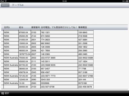

If I delete layout_width(),then the table is collapsed as the first image.

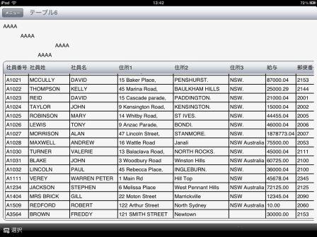

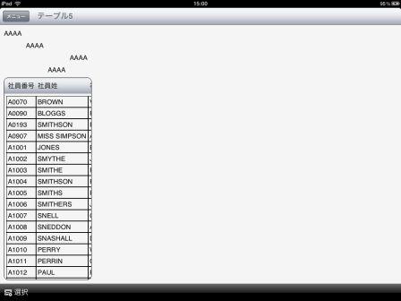

If I put layout_width(*Fill) to the fifth(most right) column, then the table expand too much as the second and thrid images.
